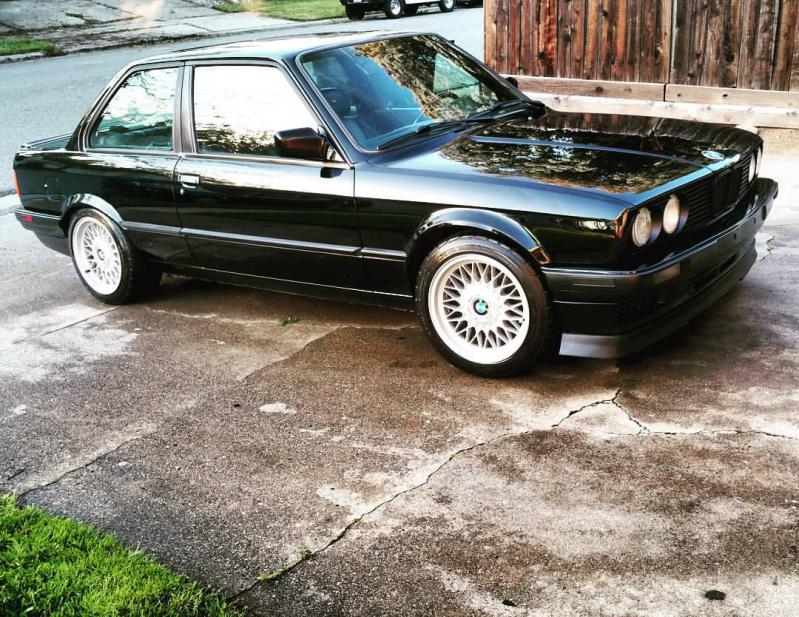

    Been running these wheels pretty hard for 9 months with no issues filled and drilled with 12mm hubcentric spacers on the front to clear the calipers. Tires are 205/50/16. I customized the centercaps a little and have about 60 hours in to refinishing them. Looking to another set for my next e30. My only compliant is they are pretty heavy. The upcoming turbo should help with that

      Another one without the center caps shows the 4 lug.
          Which style 5s are those from? I'm running style 5s from the E39 BBS RC 090 I think it's the wheel but I got rubbing issues. Where did you get those 16"s
