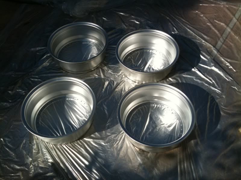

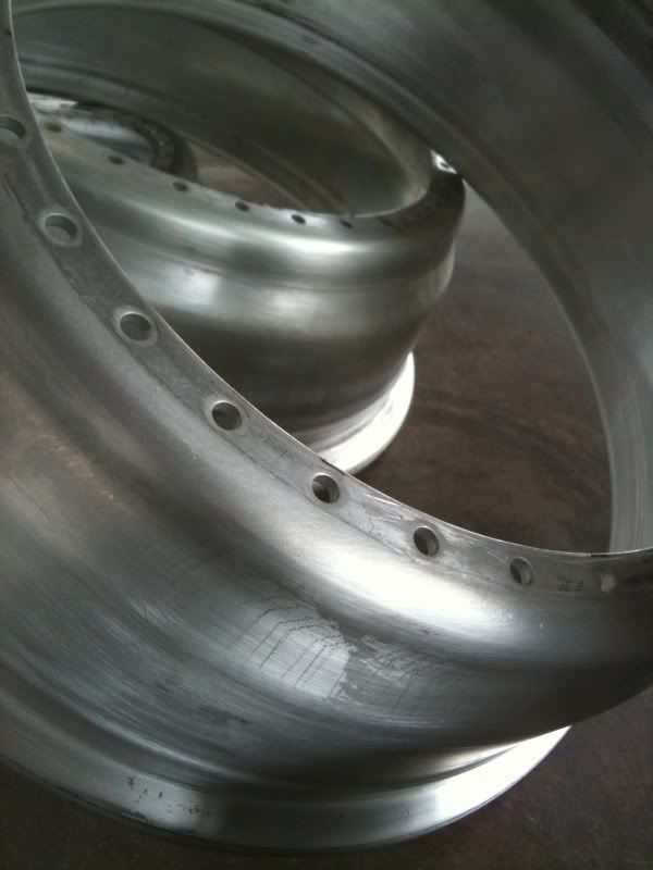

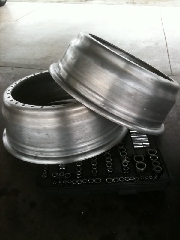

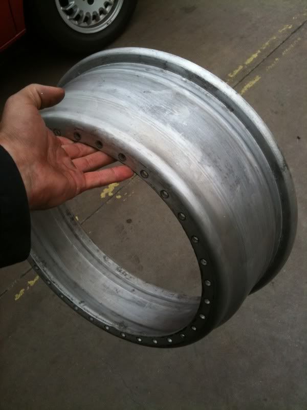

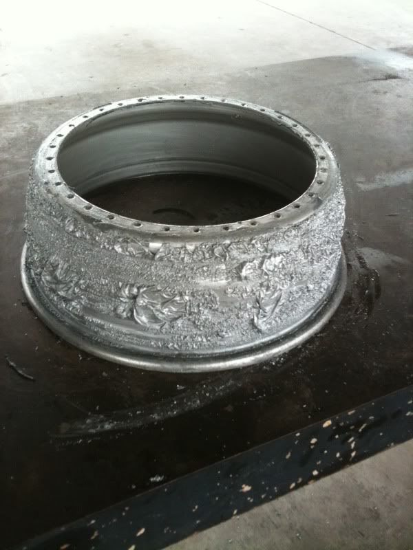

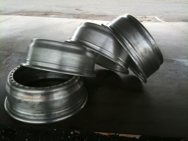

    Inner barrels stripped and painted:

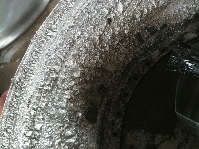

    Aircraft remover doing its thing...
    Had to apply 2-3 coats each side of the barrel. The first coat will remove the majority of the paint, second should do the rest. Lastly I hit the stubborn spots with dabs of it. I used a scraper, rags and several 3M scuff pads to remove the bubbled paint. after 2 barrels i had the technique down quite well.
    First 2 done.
    Close up.
    4.5 hours later... All 4 barrels DONE.
    Once i was done there was a light film on the barrels from the aircraft remover, so i coated them with simple green then hit them with a pressure washer. After that, dried them up and it was onto paint.

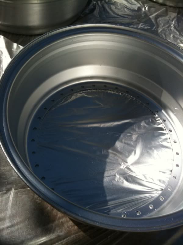

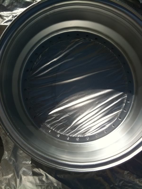

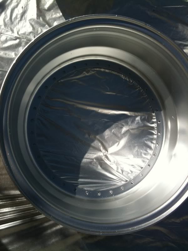

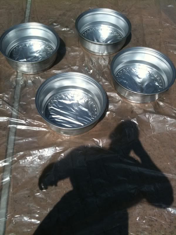

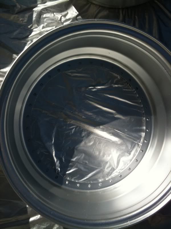

    It was difficult to find a legit color for the barrels but in the end i shose some rattle can rusto, the color code is 7715 ALUMINUM. Bought 5 cans, used 2, that gave me 6 coats on the inner of the barrel.
    First coat of paint. At first it looked way too shiny.. but after it was all dried and cured, the finish dulled down and it looks great. Heres some more progress pics taken while painting, excuse the brightness of the finish.
    Heres all 4 barrels close up, HUGE difference from the before pics...
    BEFORE:
    AFTER:
    Wheels are ready to bolt up and seal. Waiting on my 12pt 8mm socket from amazon, once that arrives I'll do a test fit and get the fenders rolled. Stay tuned for pics of the bolted up wheels and test fit.
