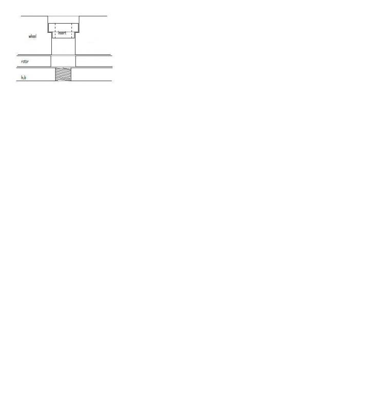

                Generally fill and drill is preferred to inserts but inserts can be acceptable (re style 5s). But that is the worst insert job i've ever seen. They drilled all the way through instead of just creating a recess. Why they would do that is beyond me. Now its more prone to pull the insert through the minimal material that is left over. Also they deformed the center bore. Thats going to make it a bitch to get the hubcentric spacer in. Your going to probably have to press or hammer it in place and you'll risk dislodging one of the inserts.
