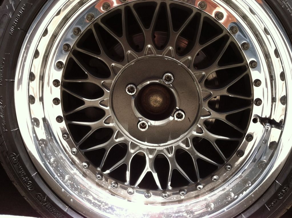

    so, just so i'm clear (i bought these a few days ago)
    - the center bore will need to be drilled to exactly 57.1mm and will fit without a spacer at all?
    - no ring required?
    Also, i plan on not running the center cap; i want my centers to be smoothed and in doing so the shop said i'd lose it. i like them better without the cap anyway.

      Was the bore filled at all? What is the bore diameter now? Is it untouched or has been altered?

        the shop that i sent them to hasn't received them yet. but i did communicate with them yesterday and asked what was the center bore for E30s (to test the knowledge) that they would drill to and he said 57.1mm. a little reassuring..
          Please post pics of this when you get them back!
            Oh so they are filling the bore after all and than drilling it to the right size. Copy that..........
            You will need an 8 to 10mm spacer in the front to clear the caliper brackets.
            Or shave the bracket down 5-8mm.

              Shave the back of the rim.

                                Old bump, for new peeps looking to have this done. Had mine for, maybe 4 years, no extra material in middle. Never an issue
