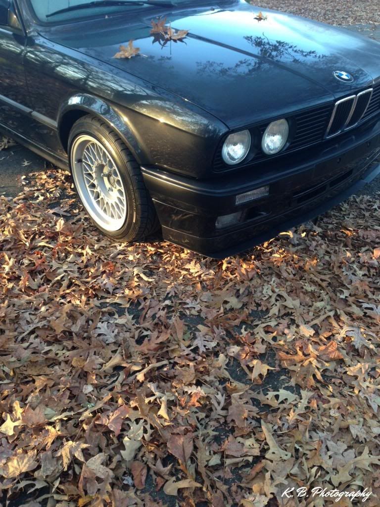

            proper car deserves proper pic!!!!moar please :-)

              #96
              here's a few
