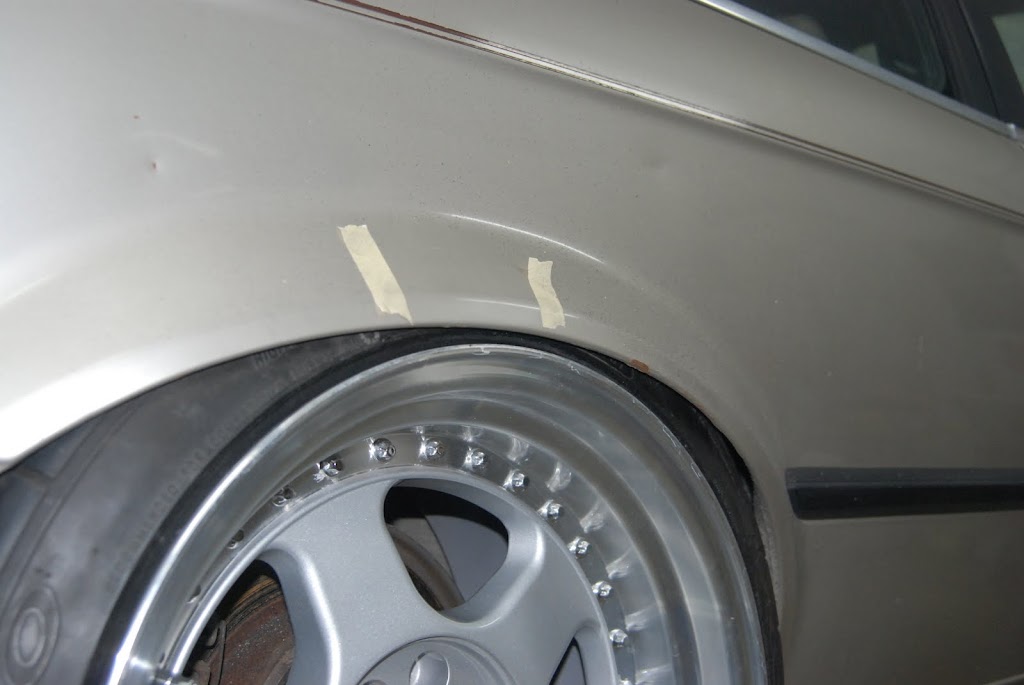

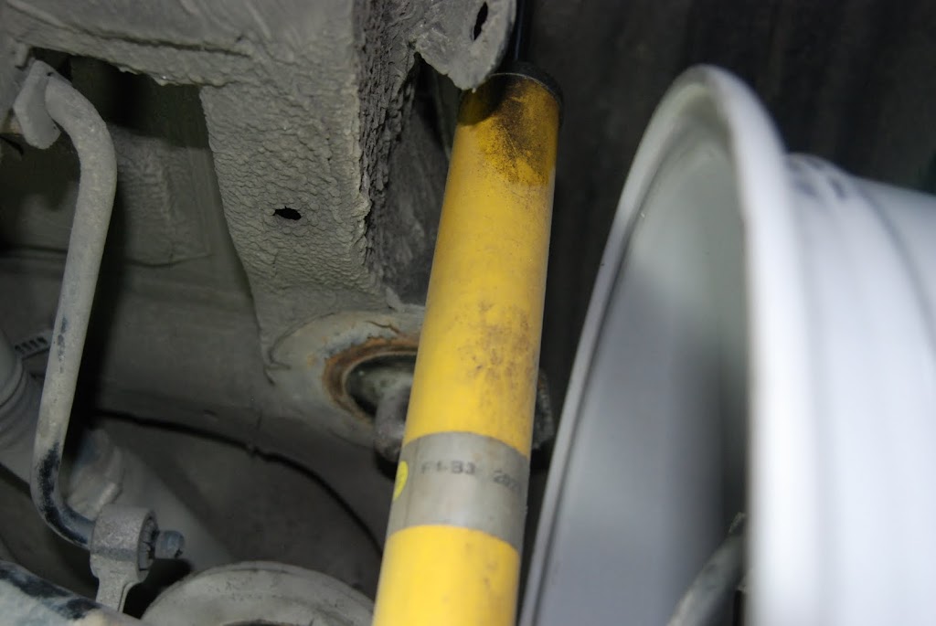

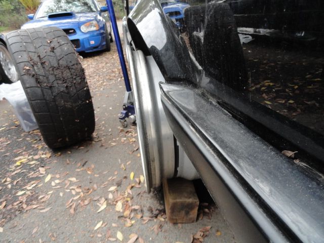

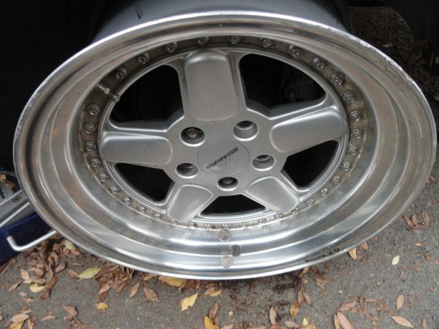

          17x10 et20
          Stock suspension geometry
          Did some more test fit (with spring removed) and trimming inside fender. Here is some pictures on the wheel without tire:
          Egde of the wheel contact fender:
          Shock clearance. If you look carefully, you will see that I had to cut the spring support on the chassis to mount the wheel.
          Now with 235/40 Toyo RA1. This is the position where the tire contact the fender, just barely before the wheel contact the fender.
          Is is possible to run a setup like this and to avoid the wheel contacting the fender without pulling more on the fender? How high of spring rate should I run? I actually have soft 300lb/in with 60mm drop.
          I have seen so many pictures of setup that was looking like the wheel would contact the fender is the suspension travel was going to allow it...
          I don't what the wheel to destroy the fender on big bump...

            #35
            some stiff springs like 750lbs/in

              #36
              more then that im running 783lbs/in in the rear and i still rub, and i have a little more space then that.

                #37
                Does your fitment make it possible that the wheel touchs the fender? does it ever happened?
