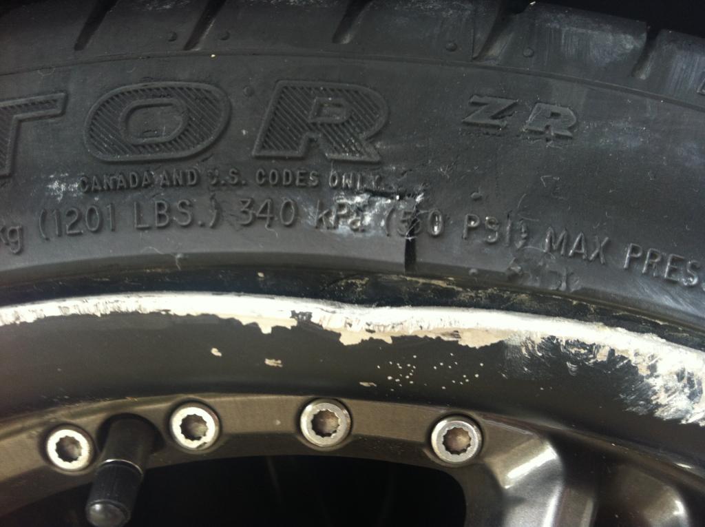

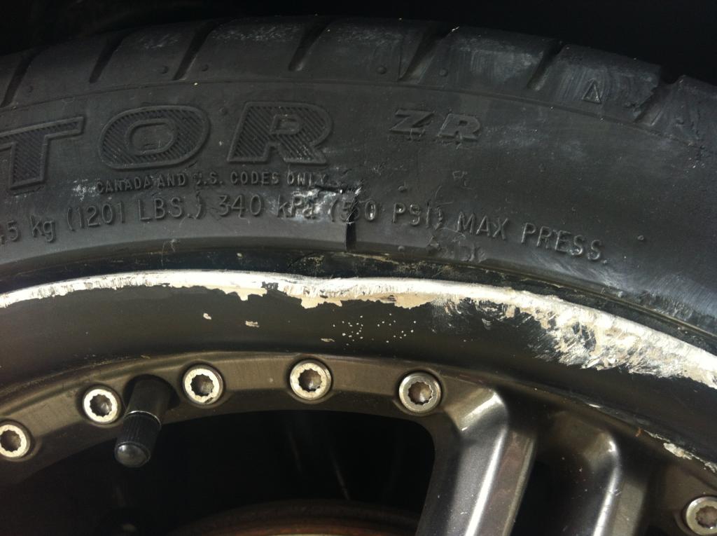

    The other day I was pulling a U-turn in a neighborhood really hard and it was raining and I ran into a curb because I was being careless. Do you think I could fix this?
    I was thinking of using a hammer but I might screw it up some more.

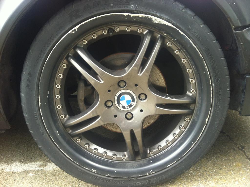

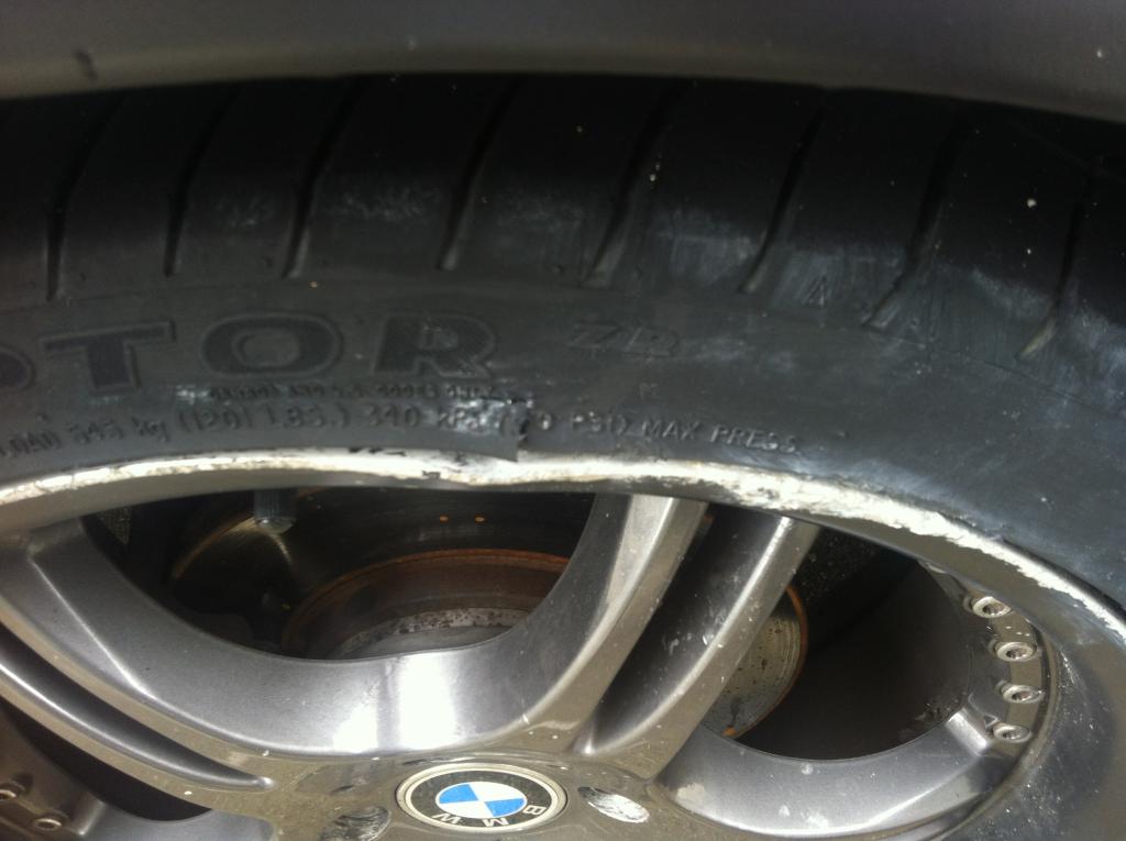

    and the whole rim.

            Right up until you hit a curb. Where is this wheel mounted on your car? front? rear? left/right?
            All smart-ass remarks aside, if you try to straighten that, it will crack.

                  Keep the hammer in the tool chest and use a stiff rubber mallet. There is a lot of material missing, so nothing is going to fix that besides adding more metal and grinding smooth again.

                    If he hits it with ANYTHING to try to bend it back it will crack. Aluminum doesn't like to bend twice.

                              I had 2 like this (with rash) and just had a bend fixed from when the car got t-boned. The last one they called me to come pick it up before I got home. Each wheel ran $130-140 plus re & re the tire if it was still on. Discount where I bought the tires would have removed & replaced them for free if I stopped by. The repair shop was doing a late model Porsche wheel that was owned by the local Porsche dealer so that was all the recommendation I needed.
                              They have some high tech equipment to ease the bent out since aluminum is very brittle. You ruin one wheel you ruin the set. Last one had cracked paint which disappeared when they fixed it.
