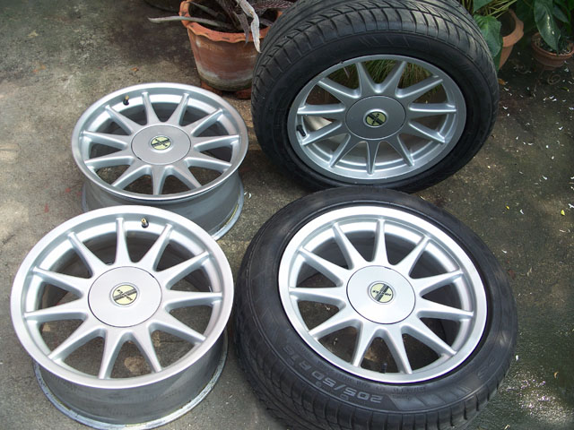

    Just bought an original set of E30 Hartge wheels out of Thailand and need to find tires. Wheels are 16 X 7.5 with a 25 ET. Should I go with 215/45/16 or 205/50/16. Worried the 205s will make the car look to high. Also, car sits fairly low, will I need spacers to clear the strut?

    I had 225/45 on mine, then switched to 205/50 when buying new tires due to selection.
    Both sizes looked great and will maintain the correct overall diameter. No spacer needed!

              Corect size for these wheels is 225/45/16, keeps the rolling distance about the same.

                215/45, 225/45, 205/50 and even 225/50 are all acceptable (with 215 being a tiny bit short, and 225/50 being a tiny bit tall).
