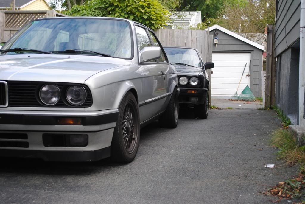

                          +1 For this setup! I find an 18-20mm spacer in the back(with a slight roll) and a 20mm spacers up front do wonders for it.
                          (pic with 12mm spacers up front, 20mm rear)
