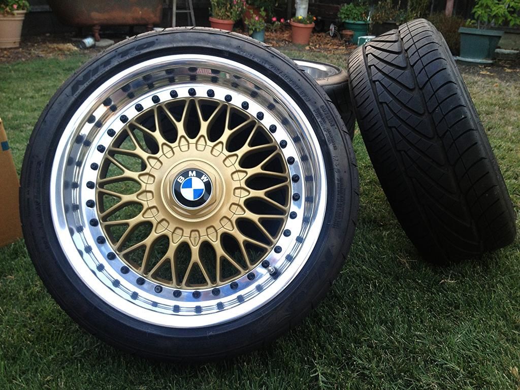

    I've recently picked up a set of 2piece style 5's. I would like to run them on my e30m3. I was interested in what you guys run for a tire size. I don't like the "strech'd" look so I would like to keep away from that. If some people would like to Post some Pictures with tire size, That would be great so
    I could visualize the fitment. Thanks.

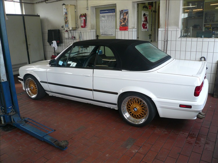

                  Here is an example of a Nitto 215 40 on an RC090. Theyre stretched a bit, Im not a fan of the stretched look either. Once I go through these Ill install my 245 35's on the rears (I bought a pair a while back), probably will stay 215 40 up front as I dont have the greater M3 fender clearance to make a wider tire work out.
