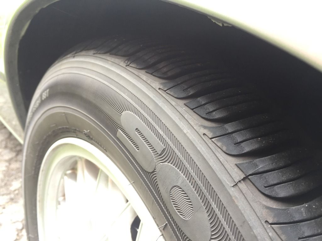

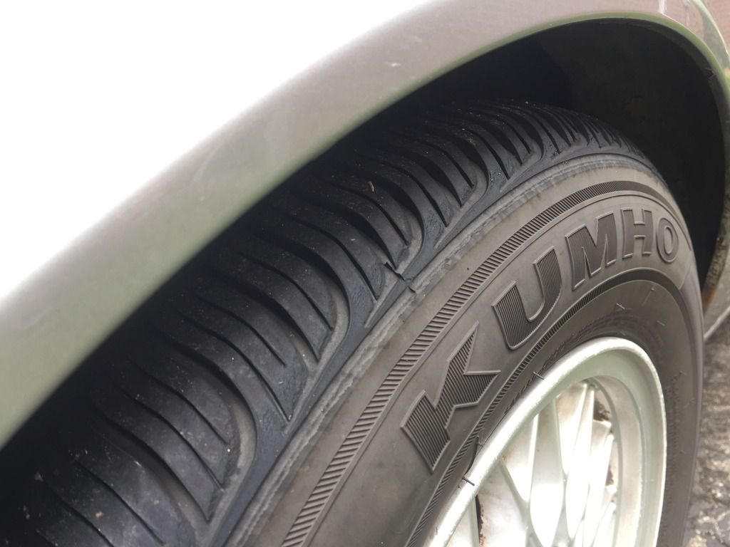

        Front tires after the first (~8 minute) shakedown session.

        Front tires afterwards (took pictures days later, it rained for a while!)

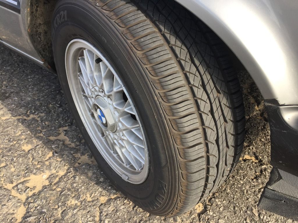

        Rear tires afterwards

          You could be pushing those a lot harder. That's about what my tires look like after commuting to work. It's not like a motorcycle where your track day is over if you lose the front end once.
