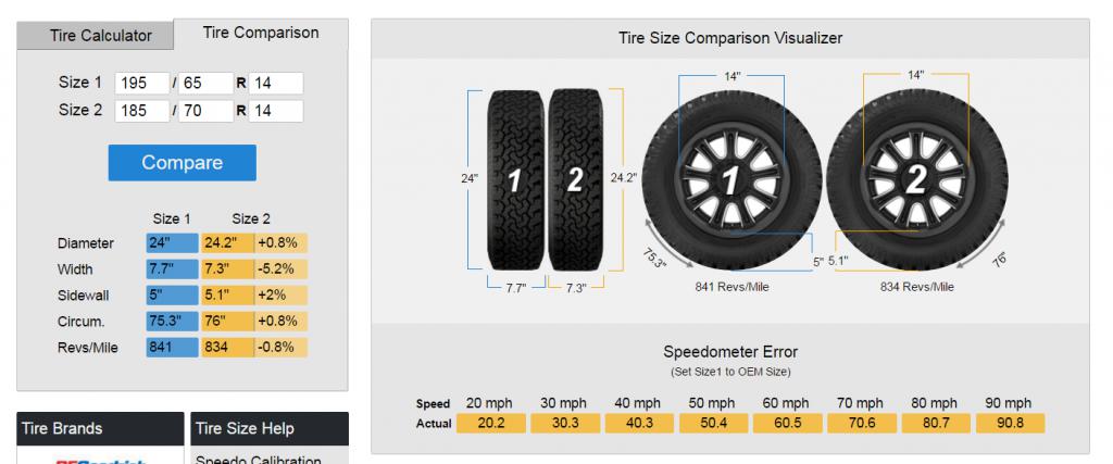

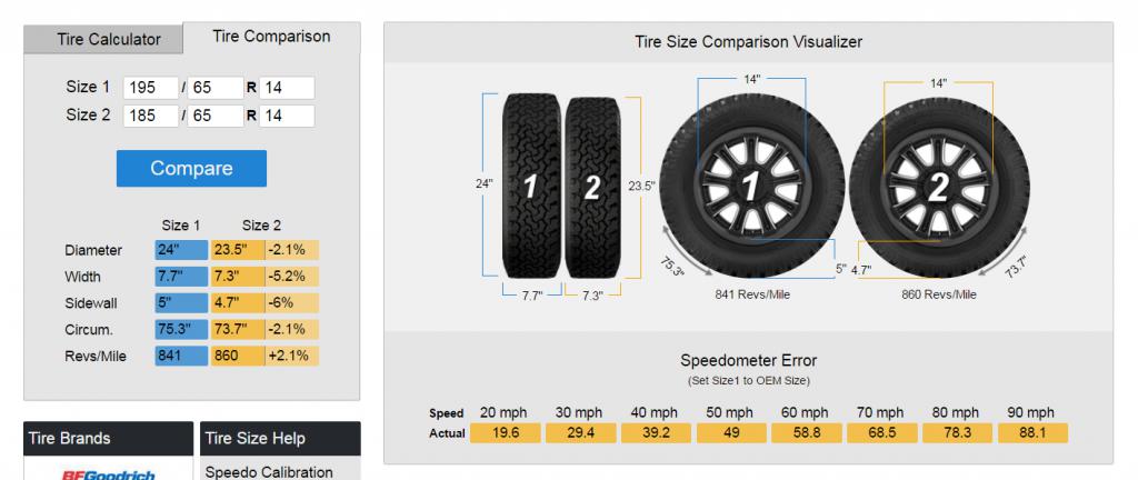

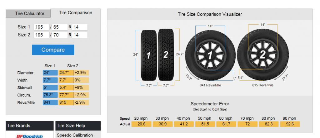

    For reference, here are some size comparisons for non-standard sidewall heights and tread widths.
