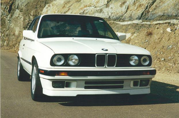

                Actually 225/50-15 is rated for use on rims that are 6" to 8" wide. They are a perfect on a 7" rim width and the sidewalls are generally squared up. R-compound versions tend to have a wider cross-section width compared to street tires but it's not an issue since the rims are in the middle of the spec'd range.
                I've tracked and autocrossed 225 tires on 6", 7", and 7.5" rim widths in the past with no issues. They looked at little pooched on the 6 inchers, but performed great.
                I have also run 205/50-15 Falken Azenis on 7" Kosei K1s and they were a little stretched, but worked fine. I later ran the same tire on my 7.5" Ronals and that extra stretch looked worse, but the tires stayed on the rims.
                Here's a good angle showing 225/50-15 Kumho V700 Victoracer tires on my 15x7 ET27 Kosei K1s. The V700's cross section was a little wider than my Dunlop and BFG street tires.
