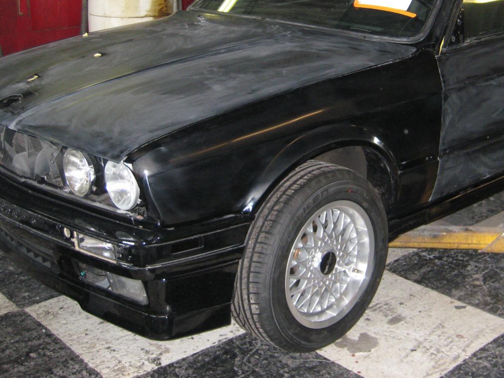

So I have a set of BBS RA's that are 14"X6.25" with an offset of 30. The stock stud length is too short for me to mount them. The 45mm spare studs I have are too long (rubbing wheel hub innards). So, since I have the longer ones, what size spacer would I need to get an offset equivalent to like 25?Comment
