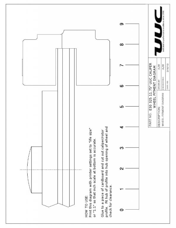

Current setup:
- 1987 325is w/ 4-bolt hubs
- Bilstein Sport front
- Koni SA rear
- H&R Race springs
- Racing Dynamics sways - 22mm front / 19mm rear
- E30 M3 camber bushings
- Dinan fixed camber plates - 3°
- UUC BBK (see attached fitment template)
I want to stay with 16" rims.
Is it possible to run 235s? What offset will allow the widest tire width?
