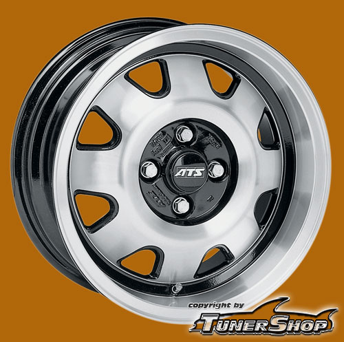

      Hi guys, saw these on E-bay, they're sold for VW but will they fit an E-30 1987?
      They are 4x100 15x7" ET20
      If they fit any tire recomendations?
      Thanks
                  Thanks
                  Yup, those are made for the E30. 205/55 or 205/50.
