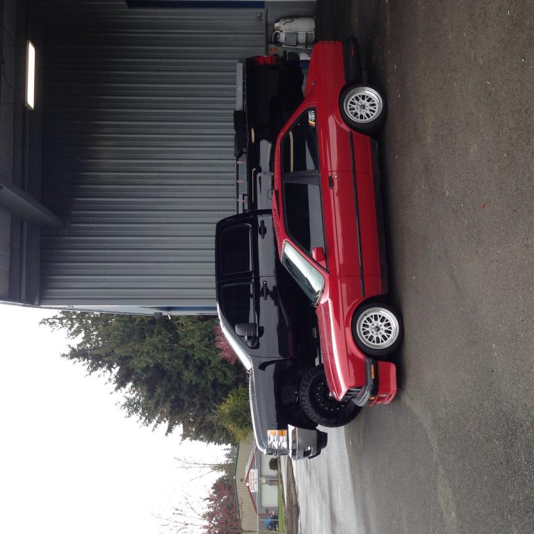

              • Joev253
                • Sep 2013
                • 60
                #7372
                Hey guys I'm gonna be running some 16x9's et 15 with 205/45 tires I'm lowered on catuned coilovers I was wondering what size spacers I should run because I want some poke thanks here's a pic of my e30

                  #7373
                  From where your wheels sit now how far out do you want to poke?
