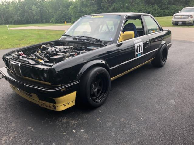

15x9 ET0 Fitment
15x9 Rota Grid-V's ET0 with 245/40R15 Maxxis RC1 Slicks.
Rear fitment is perfect and does not rub at all with no spacers.
Fronts stick out about 1 inch and that's with a 15mm spacer (All I had) Switching to a little smaller 12mm spacer to tuck them in little more. Very minimal rubbing on the front. This is a temporary setup but just wanted to post this to show that it does work. I will be putting on bolt-on over fenders in the future. This is a dedicated track car so I am running Ground Control Coilovers. Handling is fantastic even with the front track being wider than the rear.
Say what you will about this setup but it works great for me.
