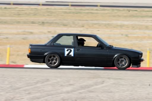

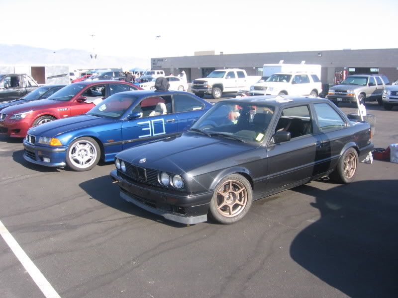

          • 2002maniac
            • 4260
            These are the best pictures I could find of mine. 225/45/15 Hoosier R6 on 15x8 et20 Rotas. The absolute perfect setup...
            before the paint job
            on 15x7 kosei
            • 2002maniac
              • 4260
              That's my little brother, not me btw.
