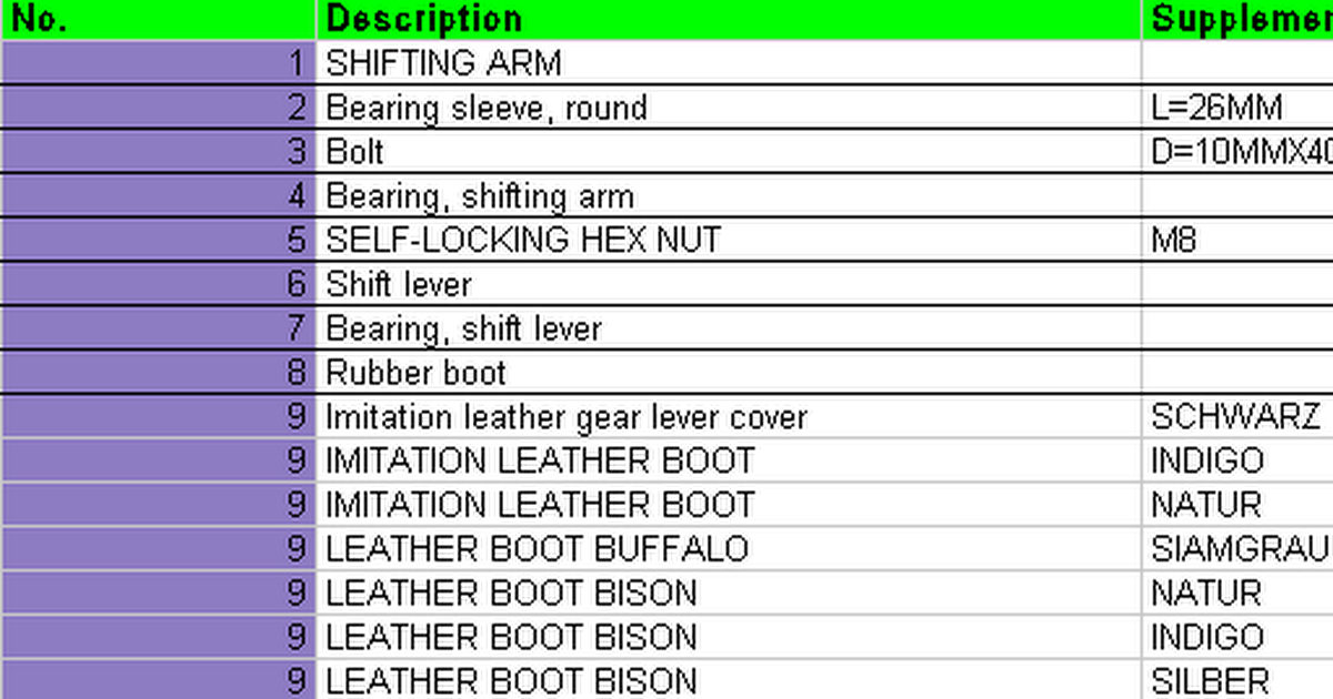

              I have a massive spreadsheet with parts. I just finished ordering everything I need. Let me find it

                Here you go.
                A few notes. I have tabs for the rear subframe because originally I was going to do that as well.
                There is a column called "Need".
                -Red means need
                -Yellow means maybe (based on evaluating the part I had)
                -Green is a confirmation that I received a formally red needed part.
                I replaced a lot of bolts because my wagon is a northern car. I'm also someone who does a lot of "while you're there" kind of replacement. I usually weigh wear/cost/location for if hardware is ordered new or reused. Some red parts might not be applicable to you because they broke or I considered them not good enough to reuse (i.e. shifter rod and carrier broke during the engine pull out :( )

                  Wow, that is a pretty amazing google doc sir!

                      I'm glad you guys got some use out of it. There are so many little parts that should be replaced that a spreadsheet was needed.
                      The hard line from the master to slave seems like an unnecessarily long hard line. Mine is wrapped around one to two times before it goes into the slave cylinder.
