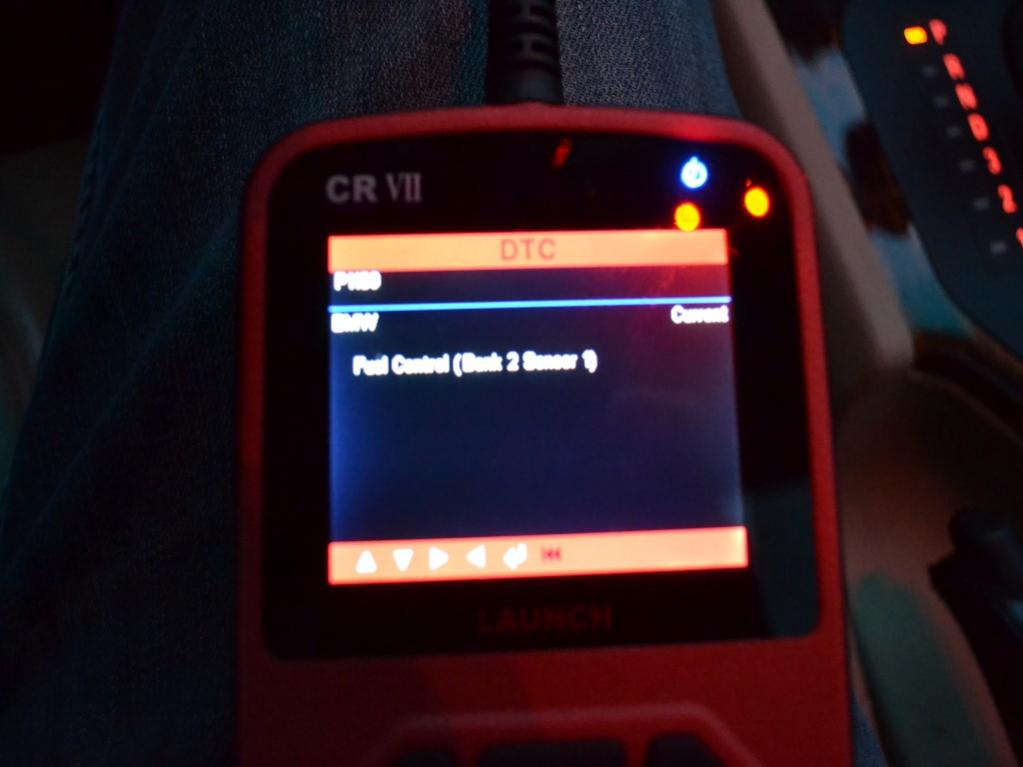

    Still brings me back this code, my friend says I need a new O2 Sensor.
    • E30NJ
      • Aug 2013
      • 921
      #32

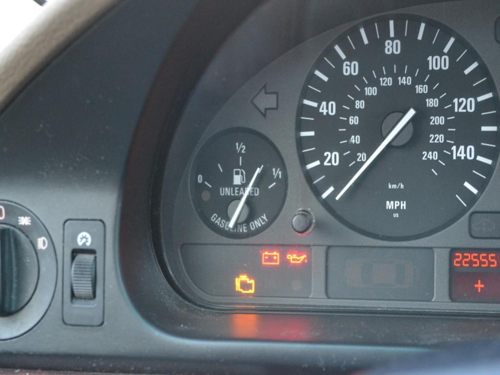

      CEL cam back on. Same code- P1189 Fuel Control Bank 2 Sensor 1.

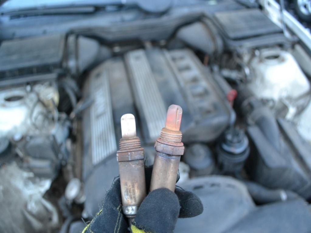

        Had a known good O2 sensor laying around. Swapo sensoro cuz!
        • E30NJ
          • Aug 2013
          • 921
          #34
          Old one on the right, Newer one on the left.
          • E30NJ
            • Aug 2013
            • 921

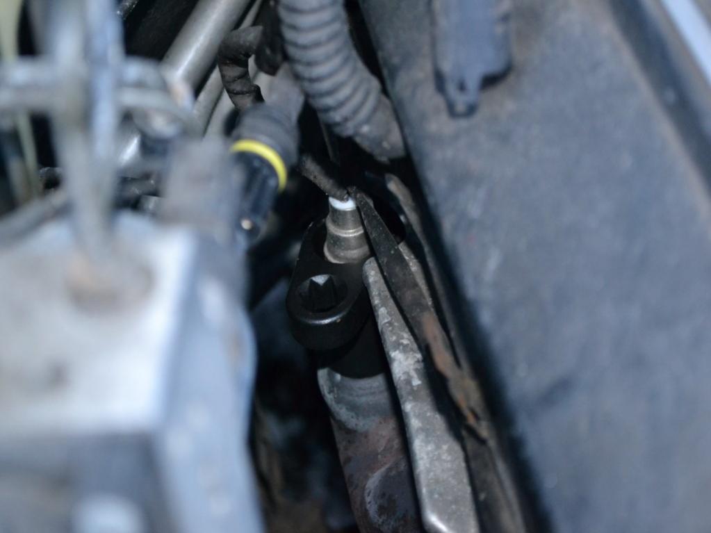

            #35
            Bit of a PITA but got it swapped in like 10 minutes!

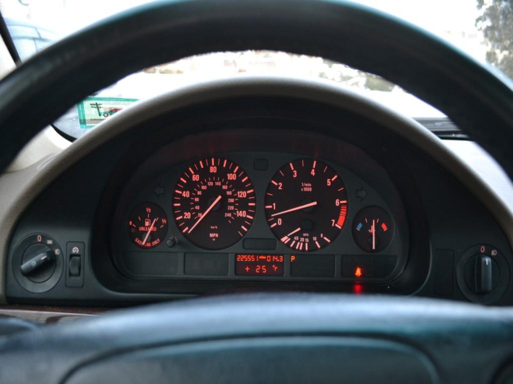

                      CEL is still on. No surprises there.
