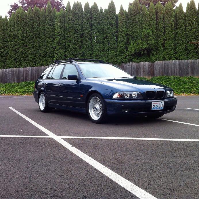

        Good deal on that! White is a great color on those.
        I have a '99 528iT, so this was cool to read through. Currently have mine parked until I fix the CCV, have a kit on the way. Found some pudding from condensation under my valve cover in the middle of doing my vanos replacement. Glad I caught it early enough. Part of it is my drives to work are too short and it doesn't get driven long enough to allow the moisture to evaporate. So be sure to test that your ccv is working properly too
        Here's mine, 140k on it

          Awesome! Love the style 5's.
