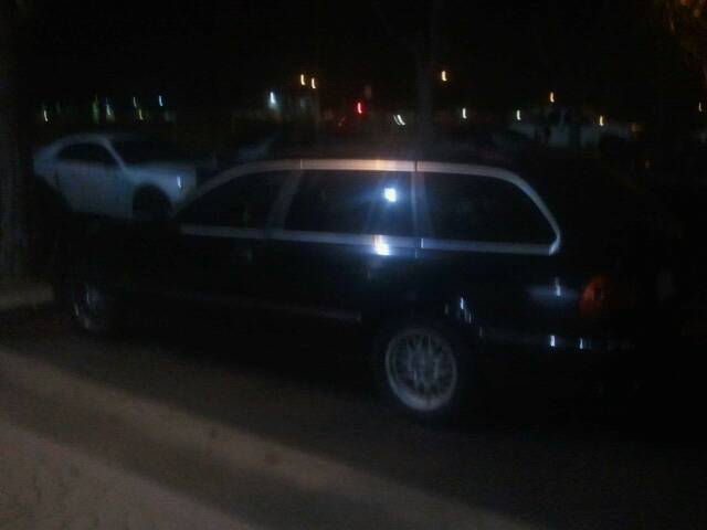

                Problem solved it was a vac leak WTF!! It was the throttle body intake boot. I guess it slipped off somehow. I notice it by the lip of throttle body which was showing,and I think is the cause. The desing of the location where boot wraps on throttle body is only as wipe as the clamp it self even I bit smaller I would say. Therefore, when one tightens the clamp boot slips off not enough surface there to clamp correct. Car is runing nice and smooth now. Sorry for crapy cell pic. I will be posting an into and future mods soon. Thanks to those whom help
