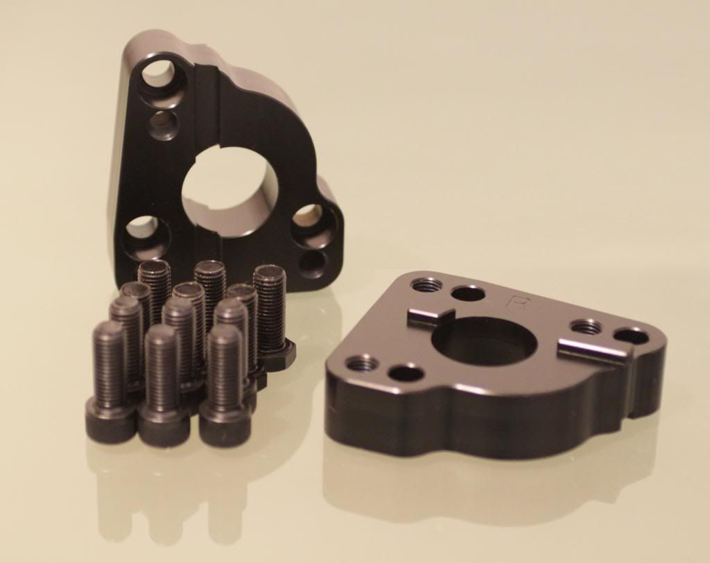

    What I would like your brilliant and useful input on is this new product, as quoted from their thread on BF.c:
    Originally posted by Bwaterman
    Introducing a new suspension product for our e34's, the camber spacer.
    These spacers are a worthwhile addition to any e34 lowered by 1" or more. They bolt in between the strut and steering plate on each front strut assembly to achieve:
    Increased static negative camber (about 1.5 degree increase), keeps the outside upright when cornering for increased grip and reduced understeer.
    Raised front roll center, decreases body roll and improves steering response.
    Wider front track width, decreases weight transfer for increased cornering grip and reduced understeer.
    Restoration of factory anti-dive geometry, reduces dive under braking.
    Un-altered king pin inclination, conventional strut top camber plates increase KPI meaning that as the wheel is turned in a corner the increase in static negative camber is lost, not a problem with these camber spacers.
    No spring to strut tower clearance issues, normally you have to have coil-overs to get any more than an extra 0.5 degree of camber but these clear with ease.
    Of course there has to be a negative to balance against these positives and that is that these spacers increase the scrub radius, similar to running low offset wheel or wheel spacers. However I have had these plates installed on my car for some time now and have not experienced any adverse effects from the increase in scrub radius.
    The spacers are 1" thick and will clear most wheels 16" and larger.
    They are made from CNC Machined 6061 T6 High strength billet alloy, anodized black for an oem look. They are supplied will all the required high grade fasteners for installation.
    These spacers are available in limited quantity for $195.00 + Postage per set, with further stock being produced once sufficient demand has been established. Custom colors and sizes available upon request POA.
    Reply in this thread or send me a PM if you are interested in a set.
    Regards,
    Brendan

    They just look like roll center spacers, similar product exists for e30m3.

      Right...so how does that affect caster or camber, and how does that change the driving experience? Thats the shit I wanna know about...will this help get rid of some "push"?

        To the best of my understanding, it will take away some of the camber gain you get when lowering the car by adjusting the lower arm down closer to its original position.
        Mostly thou, they tend to help with bump steer.
        He best way to get neutral handling, or less push is:
        Make sure rear toe is in spec after lowering. This usually means kmac Rtabs or adjustable rear subframes (weld on). The camber curve is aggressive on e34s.
        The toe curve is even more so. I've seen cars lowered 50-60mm shift from toe in, to upto a degree of toe out. Very stable, but Eats the inner edge of the tire, not conducive to neutral handling.
        "Square" wheel set up. Wider rears=more traction at the rear=understeer
        Larger rear bar... Think the cheap oem upgrade is an M5 rear bar.
        Really big upgrade is m5t rear bar.
        Adjust tire pressures.
        I used to set my fronts to optimum pressure, by reading the tread pattern with water or blue snap line chalk, then run 3-4 psi more in the rear.
        Exact opposite of what the rules say to do, but effectively reduces rear contact patch and sidewall give for slightly LESS rear traction.
