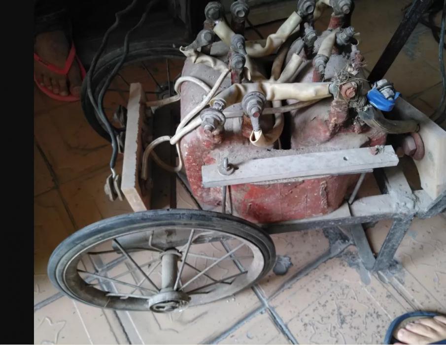

      The best way to learn to weld is to start welding, even if the best you find is a soviet-era stick like this one
      just kidding
