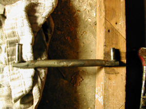

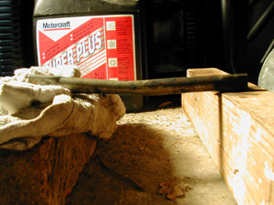

    E30 Zone shifter instructions
    The image of where to bend/dent the rod is wrong? Seems like you should be hitting it with a hammer on the bottom side to clear the damper.
  • AmosCake
    • Feb 2021
    • 215
    I guess the rod can be oriented from the left or right? Thats my mistake

      What is this even about?!?
      • 82eye
        • Jan 2009
        • 1944
        looks like the z3 shifter mod without removing the driveshaft damper. e30 zone has them bending the shift rod to clear.
        • McGyver
          • 4565
          Just remove the damper and don't bend shit for no reason.
          FYI, removing the damper will require 3 additional bolts since the damper uses 3 studs.
