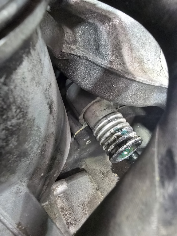

    M50 short water pipe part number
    I seem to be striking out on finding a part number to get a new one for the s52. Can anyone help?

    Could be aftermarket? M52/S52 used the hard pipe instead of that/hose.
    Click image for larger version  Name:	image.png Views:	0 Size:	125.4 KB ID:	10134552​
    If it's aftermarket, it's something like this
    https://www.bimmerworld.com/Cooling/...pter-Pipe.html
    Otherwise maybe it's an M50 timing cover.

      OBD1 timing covers had that flange in your photo. OBD2 timing covers did not.
      That adapter posted above is the ideal solution. Turner and ECS also sell it.

        Thank you! Race german had one too!
        It "looked" like the pipe could just pull out... but nope. cant wait to have the s52 in
