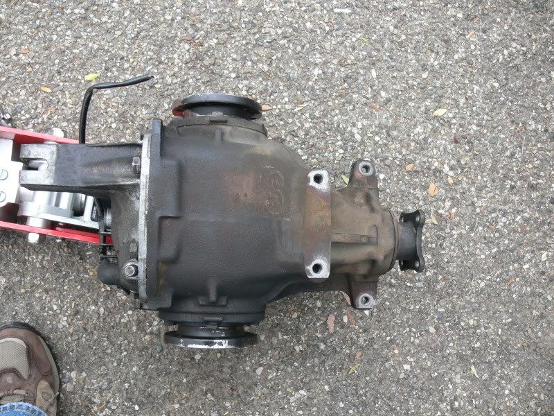

Jack up the rear of your car and put it in neutral
Spin one of your rear tires... if the other rear tire spins the same way then you've got LSD, if it spins the opposite direction then it's an open diff.
Also if the diff is ever out of your car you can check for the white "S" stamped on top:
(this one is kind of faded but you get the idea)
paint sucksComment
