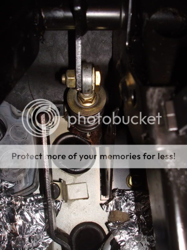

    Hey guys my clutch master cylinder is leaking
    I bought all of the items to replace it
    It looks like the clutch spring is not where its suppose to be, and it was rubbing on the blue hose that gets connected to the clutch master cylinder. It caused it to rub soo much that it tore through that line and now im wondering where is the correct location for the spring.
    I have a 87 325e and it was originally a 5 speed so we are not dealing with a 5 speed trans swap.

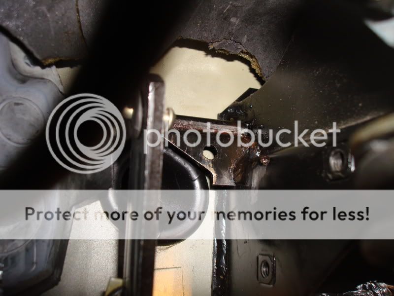

    It looks like the grove down the center on the back of the spring fits perfectly into the recessed groove on the pedal assembly.
    It also looks like there could be some sort of bolt holding it in place because there is a hole in the pedal assembly as well as on the spring.
    Does the third picture look like that is where its suppose to go?
    bolt or no bolt holding that spring in place?

                  There will not be a bolt holding that return spring in place. It sits just like that in the groove.
                  Dont get frustrated when you are pumping up the slave cylinder. The pedal will go to the floor and stay there, causing you to think something is wrong with the linkage. That assembly is a bit strange, but you'll get it. Just pump the pedal up by hand to get it off the floor and it should seat itself in the right position.

                      That's all normal and hooked up the way it's supposed to be but seriously, ixnay on the double ostpay.

                        I checked my bentley and it didn't help much
                        real oem you can't really see what the back of the spring fits into or gets bolted too.
                        I have never seen the spring in the correct oem position so I just wanted to make sure i put back together correctly.
                        thanks for the straight up answer.
                        It is pretty strange With the spring just resting in those groves, the pedal is very high compared to the brake pedal
                        hopefully when I attach the linkage on the clutch master cylinder the pedal travel will return to normal.
