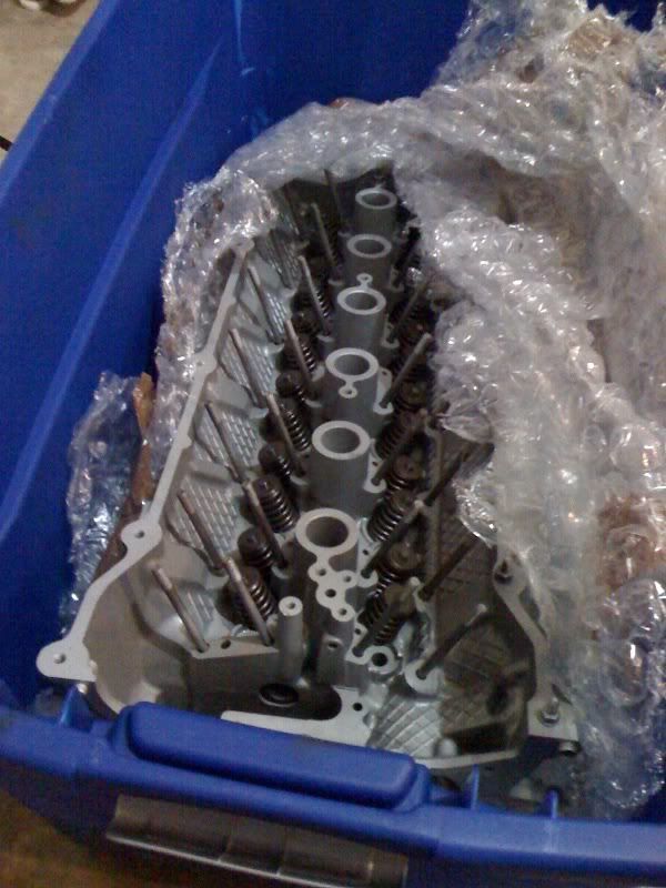

    'Yard got me the reman'd head, although the sent me an OBD-II gasket set not an OBD-I gasket set like I told them.
    Getting ready to order a Dr Vanos Stg 1, chain tensioner and a few other little things. Hoping to have the car back on the road next month.

            So what exactly happend that made you need another head?
              Blown headgasket. 'Yard said in there experience 9 times out of ten on a 24v motor the head cracks as well.
              So we'll see.
              www.gutenparts.com
                yeah between the exhaust valve guide and the water jacket... That blows..
                  a redone 24v head is a beautiful thing. why did the headgasket go? is there a thread?
                    I don't remember if I started a thread or not. Not sure why the headgasket went, didn't appear to be knocking/pinging from too far advanced ignition or anything.

                      It's great that you are back on track! Did the HG somehow take the vanos with it, or was it on its way out prior to the HG thing?
                      I Timothy 2:1-2
                        No, but the Vanos unit was pretty noisy, so I figured "while we're in there".
                        And it seems that it isn't too pricey after you get your core charge back.

                          yep, the price seems to have come down a bit though, i remember the stage one kit being more expensive. noisy vanos no more!
                            Wouldn't the only thing that not work on the OBD2 gasket set is manifold/throttle body seal
                            Excuse my ignorance, but would a full obd 1 headset work for an s52 obd 1 car? I thought the valve cover gasket was different as well?
