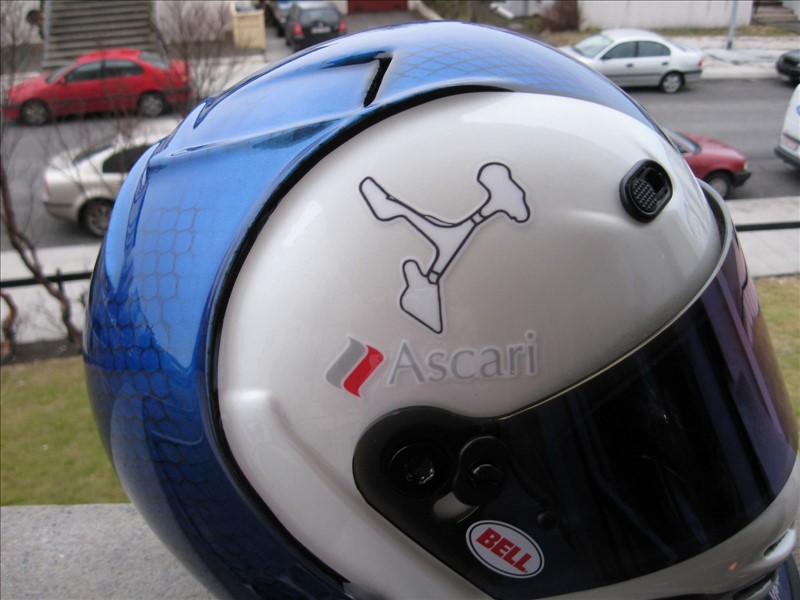

                    I bought a BELL Dominator,, http://www.bellracing.com/public/ind...duct/detail/4/
                    And got it airbrushed,, by this guy here in Iceland ,,http://killerskull.net/
                    And the helmet looks like this,, incl H.A.N.S.

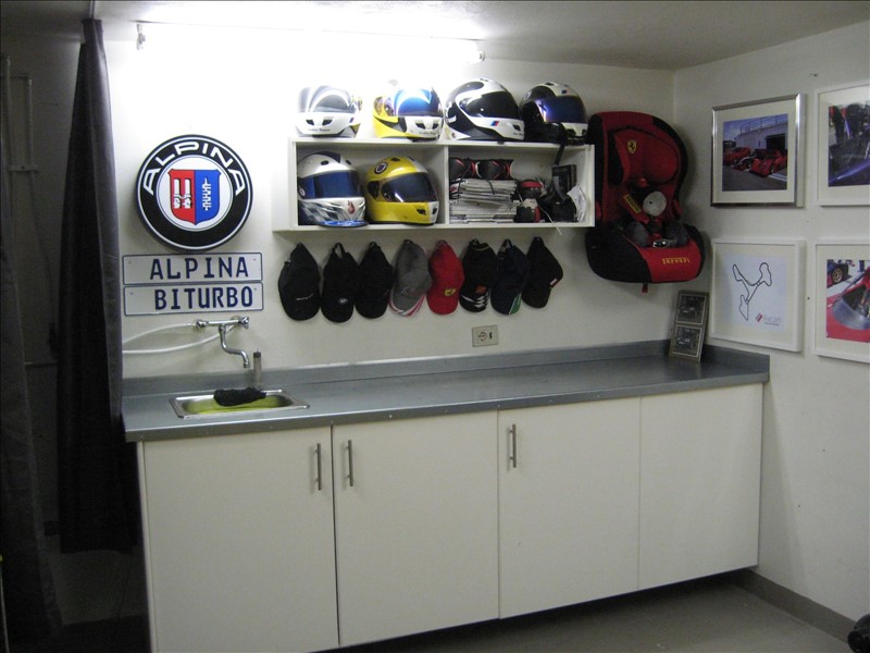

                    more helmets,,,,,,,

                      /\ Now that's a great looking helmet and garage. I'm going to look at a used full face helmet a friend of a friend has for $50. If it fits I'll just go with that until the new Snell SA 2010 helmets come out.
