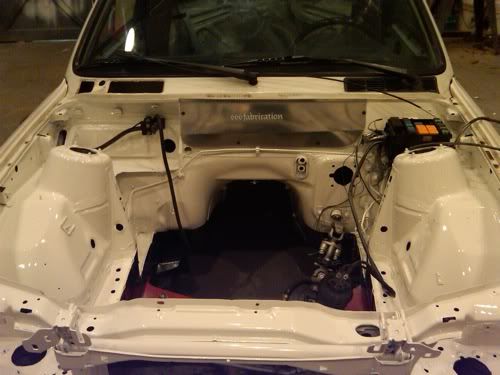

              check the seals on the firewall... one where the harness goes through and i think the other is part of heater or a/c lines ( will try to find a pic)
              E30 325is "Starting from Scratch" build thread
              • freeski27
                • Sep 2009
                • 388
                The ones in the back left
