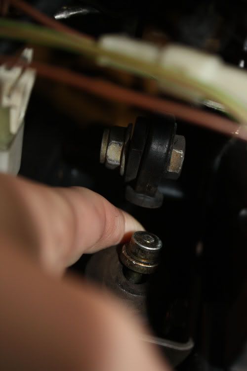

    This is hard to explain, but last night my clutch pedal started making this loud clicking noise every time I pushed in the clutch in, it was like it was slipping off something. So today I tried to leave for class ( I was gonna look at the issue after class) reverse worked fine although the clutch felt a little spongy, first gear fine, second gear clutch wouldnt return from the floor. I know that's usually an issue with the fluid or air in the system but that's not the case here. So I pulled the clutch up with my toe and decided to try turn back, tried to shift to third and when I release the clutch pedal it stayed down but the clutch itself still engaged. I drove a whole block with the pedal down and the clutch engaged. ???

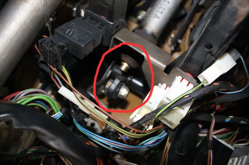

    I looked under the dash and this is what I see..
    I think the issue is the circled area.
    I believe the the red circled part is either pivoting out of the way or the blue one is bending over so that they don't line up.
    Does anyone know how I can fix this? Thanks

    Replace your clutch master cylinder
      Part of me thinks I could just tighten up the bolts in the 3rd pic, that should prevent the black piece from rotating out of the way when I push on the clutch.
      I just got the car running again and I don't want to put any more time/money into it right away..

        Nope. That black rod end is supposed to be attached to the rod of the cylinder. A brand new one is all one piece. They really aren't very expensive and not too difficult to replace.
          Look at item 1 below
          If you notice, the rod end is attached to the cylinder
            Okay I got it figured out now. I thought they were supposed to be separate pieces. Looks like ill order a master cylinder. Thanks

              You need a new master cylinder
                  ordering now. Pelican wants 56, and the local auto parts store wanted 100 bucks. Pelican it is.

                        There is no leak in the system or air in the lines. The master cylinder physically broke off the mounting point on the clutch pedal.
