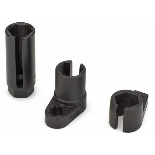

          yeah...I'm thinking I might just take the saws-all to it. Also: How the tit do remove the inner ball joint on the control arm? The one in the engine bay, It's at an angle and I can't get a socket in there because of the headers, and I can't get enough torque with a wrench because I have like 1mm of space. Cooooocccckkkkkkk.

            I used an adjustable wrench to get mine on and off. I think the ideal too is a 22mm (might be 21) stubby wrench though. Or maybe one with a ratchet.

              Yeah I think I'll have to buy a ratcheting wrench tomorrow. Just tried torching it, but it's making a fuck of a mess. haha aahhhhhh. I need to buy a shop press. Trying the saws-all now..

                        The inner ball joint nut will be 22 mmm if it is original or older and 21mm if it has been replaced recently.
                        I used a O2 sensor socket to remove it. Its offset and 22mm.
                        I have the one all the way on the right..It was about $3 at harbor freight...maybe like $15 or so at a auto parts store

                          You my good man, are a smart cookie.
