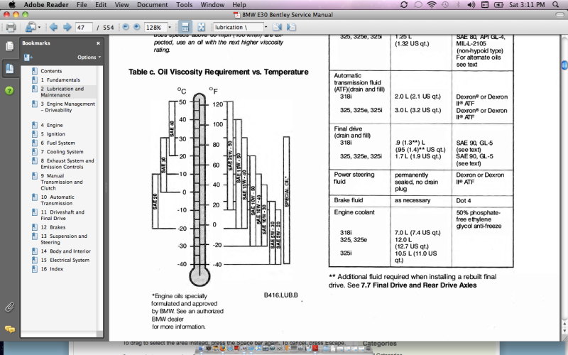

    Well I just changed my oil to 15w 50 synthetic. We'll see out it holds up

          Heres whats on the bentley manual. Its surprising how little info is on the web for such basic maintenence stuff. Looks like 15w 50 is plenty of coverage for subzero temp and summer.
          Renting my rear wheel bearing tool kit. SIR
          http://i25.photobucket.com/albums/c5...ps6debf0b0.jpg

            Here is a good 0W30
            https://www.amsoil.com/storefront/sso.aspx I have used this at Road Atlanta in an M20 in September. Ran fine and follow up oil analysis showed minimal wear.
            Having said that I currently run 10W40 synth in my M20 street car and 15W50 synth racing oil in my Spec e30.
            The following two vids show the fundamental differences in conventional vs synthetic oil cold flow properties.
            Kendall conventional 20W50 at 10 degrees F flows like molasses.
            Amsoil 20W50 synthetic at 12F flows slow but better than conventional and still as well as a conventional 20W50 at room temp. If you look closely you can see the frost on the bottle.
            Your 15W50 Mobil-1 recommendation is fine for M42 sport for Watertown. Even so, I'd let it warm up for a minute or so in sub 10F temps and then keep the reves low for another 15-30 mins.
