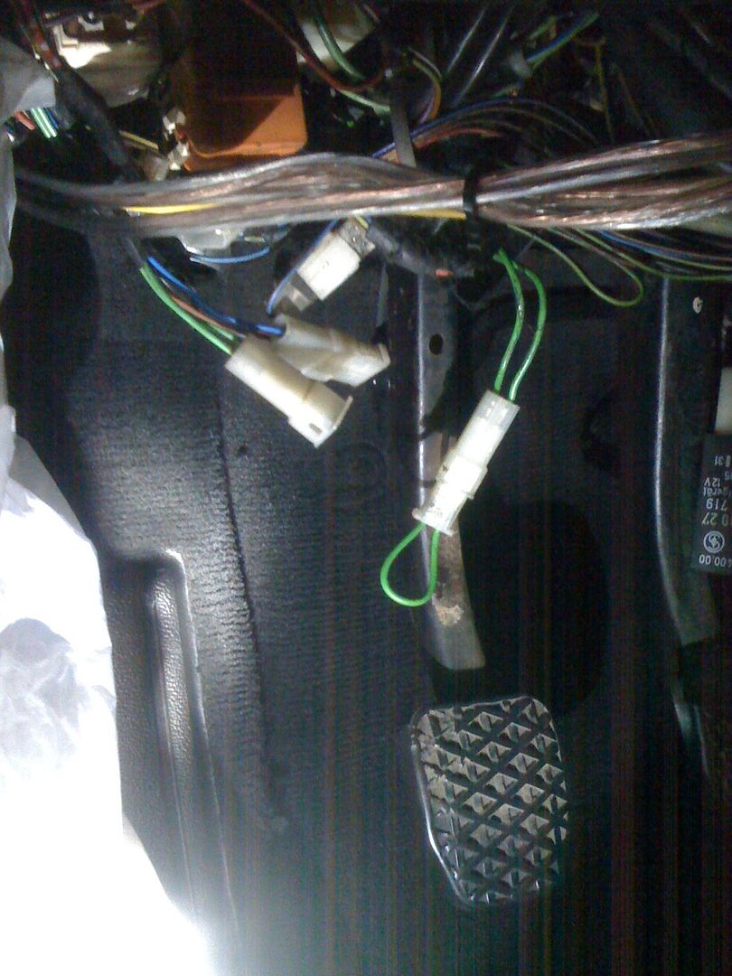

                        You need to find C104. Its a two pin connector thats back somewhere by the big accessory connector. Has two green wires. Yours will have a jumper plugged into it. You need the harness piece from an OBC car that connects it to the relay box.
                        • schtozo
                          • 1455
                          Originally posted by DaveSmed
                          I recall answering this....
                          And really, does your OBC necessitate 4 threads?
                          Thanks for your help i just realized that you provided some charts on my other thread that for some reason i missed it. I found the green cables you pointed to but both the plug from the obc harness and the plug that comes from the car are male plugs
                          the one on the left is the one from the obc harness and the right is the cars harness. So do i need to connect these together?

                          • Raxe
                            • Nov 2006
                            • 5346
                            Yep.

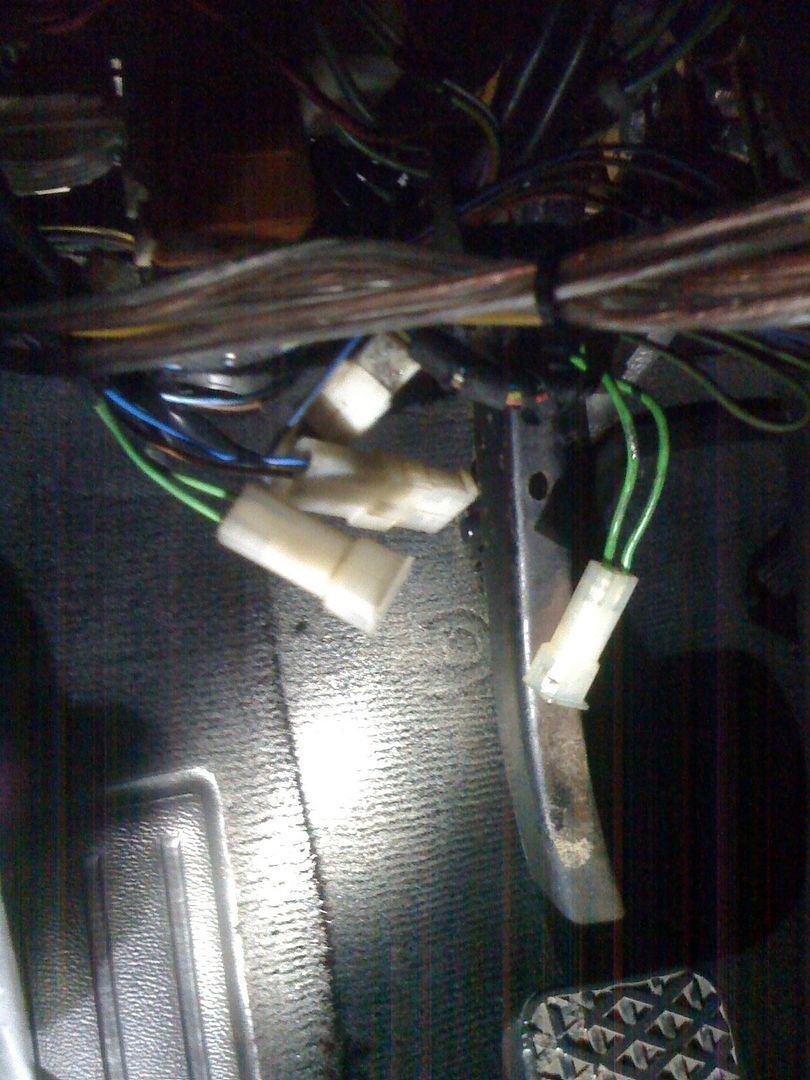

                            • schtozo
                              • 1455
                              i removed the jumper from the right plug in the pic and the car cranked but didnot start so everything ok till now, then i connected the two plugs left and right with green cables together and guess what? the car still starts without entering the code, but the OBC's relay box was ticking while the car was on. anyone?? where to check now???
