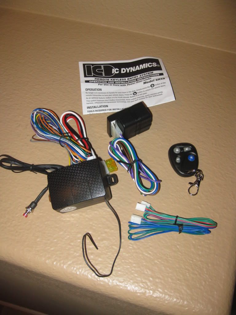

          What keyless entry system did you get? I got one for Christmas.
          Also,where did you mount it?

            I got the Omega 43T. I looks like this (http://cgi.ebay.com/ebaymotors/OMEGA...#ht_3550wt_851)
            I mounted it with zipties between the two rear lights. I took the power from the antenna wire. It's a little hard to reach but it's the only constant 12v I could find. Do you want me to PM you some pictures?

                I got the IC Dynamics 6RTA. A member on S14 says he mounted his to the truck lock actuator.
                Sure post up some pics,couldn't hurt.
