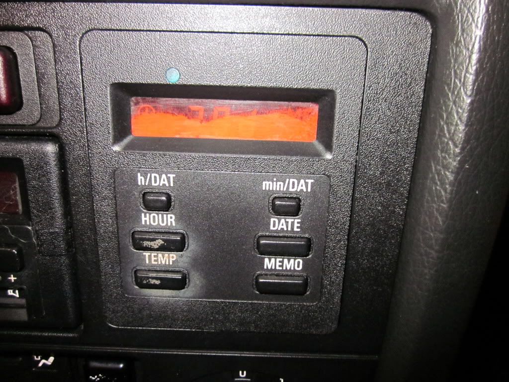

          Originally posted by AbsorbantNut
          Probably the LCD glass bar. Just go to a junkyard and get a scrap one out of a car. You unscrew 4 screws on the back, and then you pop the back cover off. Then you separate the two circut boards and youll see attached to the front one is a 3rd miniboard for the LCD. You take that out and then you can swap out the LCD glass screen. This also fixes the "lava lamp effect"
          sorry to thread jack, but is this ^^ the fix for this?:
          Or is it fubar? Sorry for the newbness.

          • DaveSmed
            • Apr 2007
            • 1407
            That would be fubar.

                • Jun 2010
                • 2491
                Yeah, thats what mine looked like
