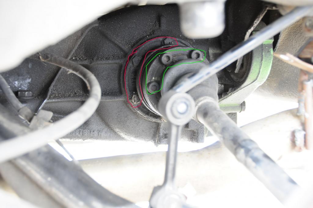

                          and another question guys, it's finally nice enough outside again and we're sanding and rust-proofing the replacement and finally trying to get the broken one out but being as cautious a guy as I am (and clueless), I'm here to ask where should I disconnect the drive axles.
                          Bentley's telling me to take the axle nut out and all that when all I want to do is move the diff. there are 6 regular bolts and 6 who-knows-what-they're-called-bolts (hex is on the inside) both at the inner cv. This seems like it'd be easier to disconnect to free the diff and get it out.
                          So should I disconnect it from the 6 regular bolts, the other ones, or do the whole axle nut route which seems like added work?

                            • Heysüß
                              • 911
                              any advice on removing the diff?
                              you think i'd be ok doing it at the inner cv?

                              • Heysüß
                                • 911
                                here's what i'm talking about... the red ones are the ones i'm think might be ok to take out.
                                but i'm pretty sure i'm wrong. I'm just being lazy and looking to cut corners.
