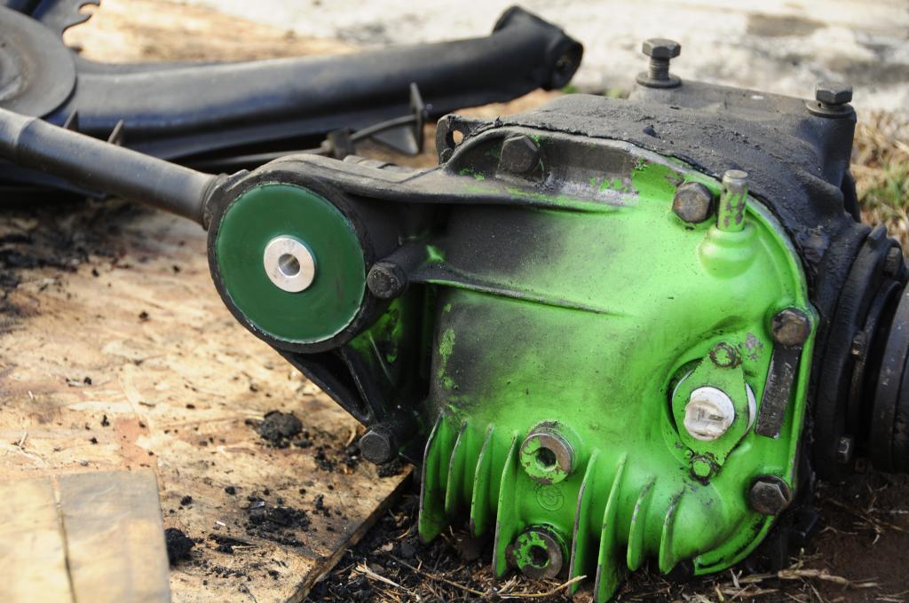

      here's a shot of the new IE diff mount.
      09/1989 325i 4 Door
      +M30 Swap
      +Z3 Steering Rack
