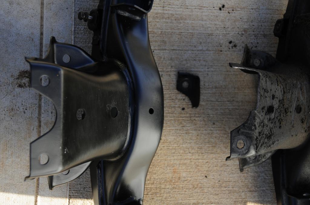

                            late, but as promised here is a picture showing the broken, not cracked, but broken piece of subframe that was causing the loss of power and awful racket.
                            09/1989 325i 4 Door
                            +M30 Swap
                            +Z3 Steering Rack
                            • Heysüß
                              • 911
                              #44
                              oh and the second top bolt was completely missing, so that's probably why the section broke off, it had to do the job of two bolts.

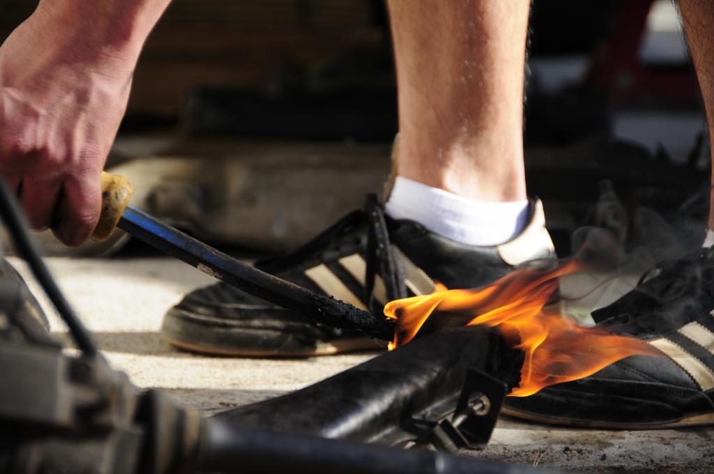

                                and here's some shots of the old bushings being taken out, or burnt out in our case.
