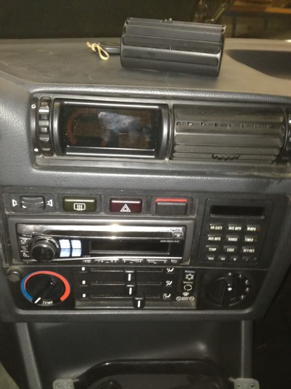

        Here are some of mine against my real Alpina piece and then installed, please excuse the dirtyness and iphone pics. I need to dig the car out of the way back of the shop to have room to finish install but there are 3 inop cars behind and around it. Thaks again to everyone that worked so hard on this piece, it really is the only gauge setup you should run as it just looks and functions so damn well.

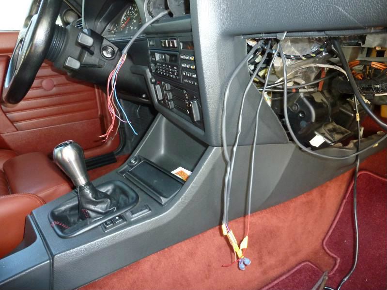

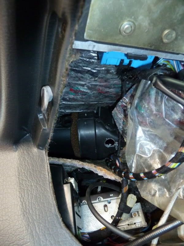

                    MC when you installed yours I assume you dremeled out the duct area to run the wires? Did you use any grommets? Pics of the install?
                    Never argue with stupid people, they will drag you down to their level and beat you with experience. -Mark Twain
                    • cactusjacks1
                      • Sep 2004
                      • 1216
                      #190

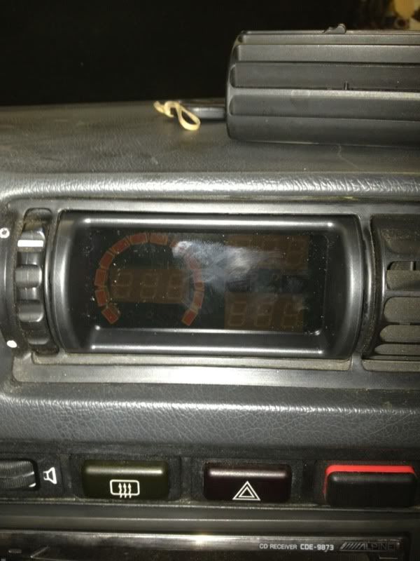

                      In installing mine, I was running 7 wires thru the hole in the duct to the back of the gauge. I used a .5" bit to drill a hole in the right side of the duct. I had shrink wrapped my wires & they just fit in the hole so I didn't seal it with a grommet.
                      Ran them thru the hole exiting the dash at the left vent opening & pulled enough so that I could comfortably have working room to attach them to the back of the gauge. After mounting the gauge in its final position, I pulled any slack back through the hole.
                      Hope that helps. I am in the process of doing a write-up on the install & will post it up when it's finished.

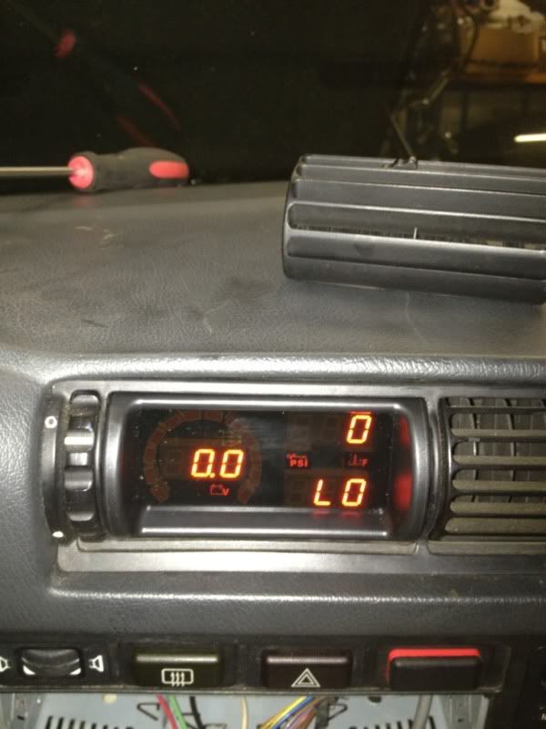

                            We got ours installed in my E30 M3. It matches the dash well and looks great. I show it to all my E30 customers and they love it! Now to get them to shell out some dough on it, as it is totally worth it.
                            If you want a clean looking interior gauge that functions and serves the purpose of several gauges then this is it!
