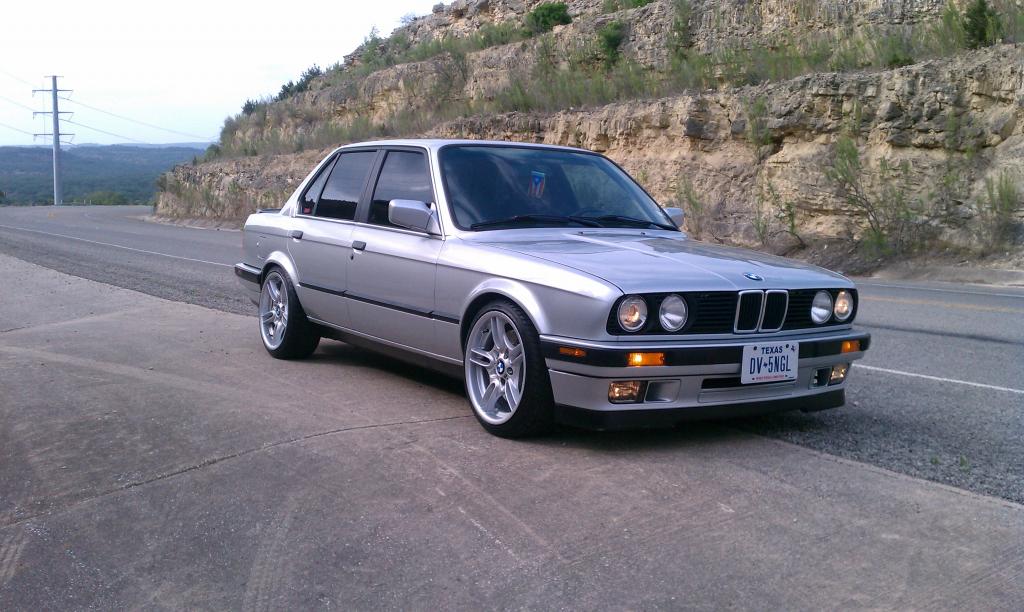

    This is my ride and I'm currently looking to put bigger brakes in the back. My rear is from a 1998 318ti. Any suggestions of where I can get them so both front (97 M3 front) and rear look similar?????? thanks.

      I just want it to look the same. I have a big rotor in the front and small one the back. Trying to find what I can put in there.
        Mount front M3 caliper and rotors in rear also?

          So it fit perfectly??? I thought there were differences? Just straight forward... i guess I'll be shopping for two m3 rear calipers.

            There's more to it than that. If your master cylinder can't flow enough fluid to move the larger piston, then your rear brakes will be close to useless.
            Serious question: why in the world do you want your rear brakes to visually match the fronts? I've seen some serious performance cars with a BBK in front and stock rears...

                Yeah, it's best to go with a solution like this ^^ where the kit is engineered to work properly as a system. Oh yeah, he can supply you with plenty big rear rotors too..

                  No, this doesn't work. You need M-Coupe trailing arms if you are gonna do this route, or fab up some adapters.
