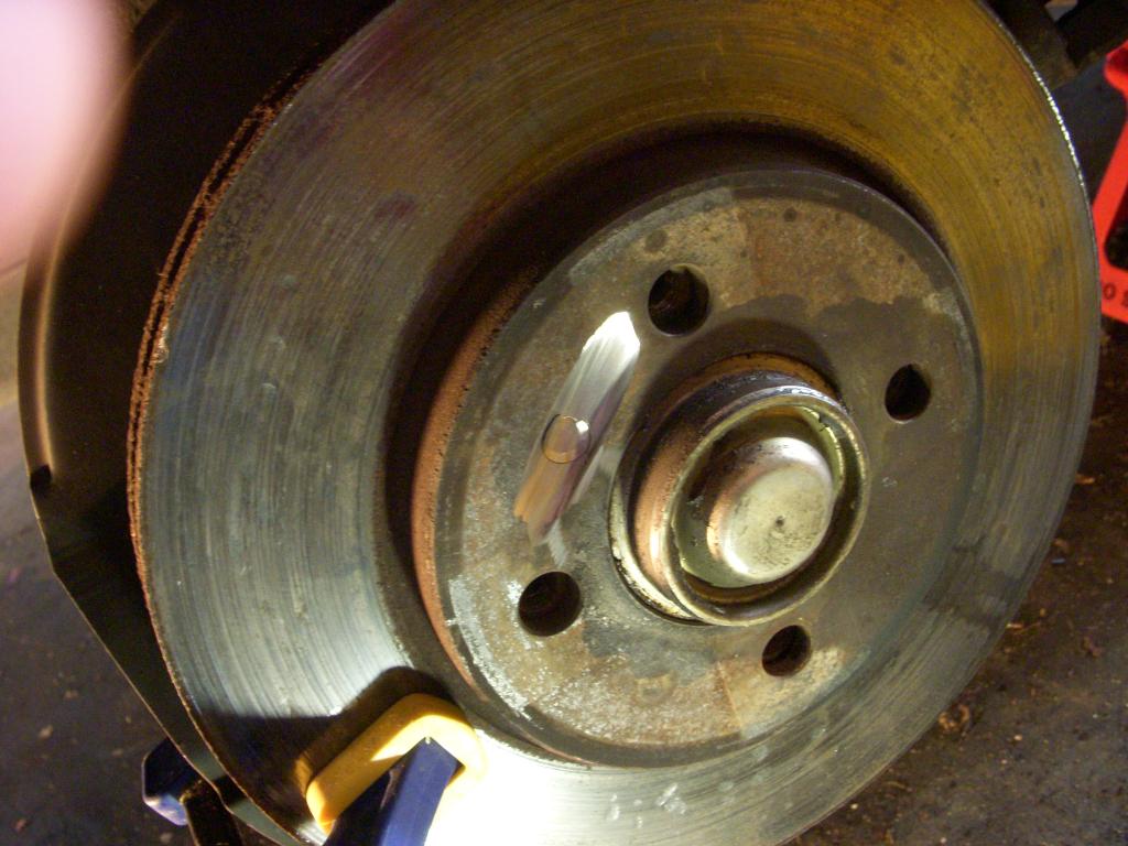

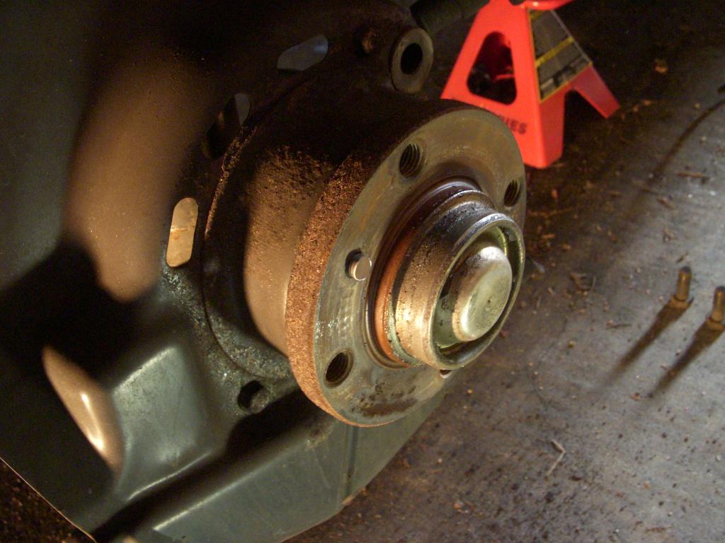

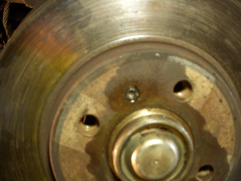

    Front rotor allen bolt stripped, now what?
    So I'm doing my brakes all around, pads and rotors. Im done with the rears and had no issues. On to the front and the driver side 5mm allen is stripped out completely! Has anyone had this happen to them? What should I do? The only thing I can think of is 'carefully' taking the rest of the allen head off with a grinder, then pull the rotor off and I'll have a bolt that I can work with. I used PB blaster prior to it stripping out. Any better options before I go to town on this with a grinder?

    5.5mm allen with a hammer. I cannot remember the standard size thats a bit bigger than the 5mm but same concept. Hammer the larger allen in as far as you can. BTW, this has happened to me several times...what a pita! I now stock new rotor screws.

        few options i've seen when people ask about this:
        - 5.5mm allen w hammer
        - cut a channel with a grinder/Dremel and use a big screwdriver to undo it
        - drill out the head, remove rotor, use vise grips or something to remove what is left of the stud
        - weld bolt/nut to it and remove

            Drill through the head of the bolt, then pull the rotor off.
            The bolt serves virtually no purpose except making it easier to keep it on there when you're installing everything. In which case, you can just screw a regular lug nut to keep the rotor steady.

              grab a punch with a sharp tip. on the outside of the hex punch it. once there is a small dimple, punch thru there but in the direction to loosen.

                          • foofopps
                            • Sep 2009
                            • 529
                            Tried the 5.5mm with no luck. Little grinding.

                            • foofopps
                              • Sep 2009
                              • 529
                              Little hammering. Thank you all for the quick responses thats what this forum is all about!
                              Now im going to soak the hell out of that bolt with PB blaster before I strip that.
