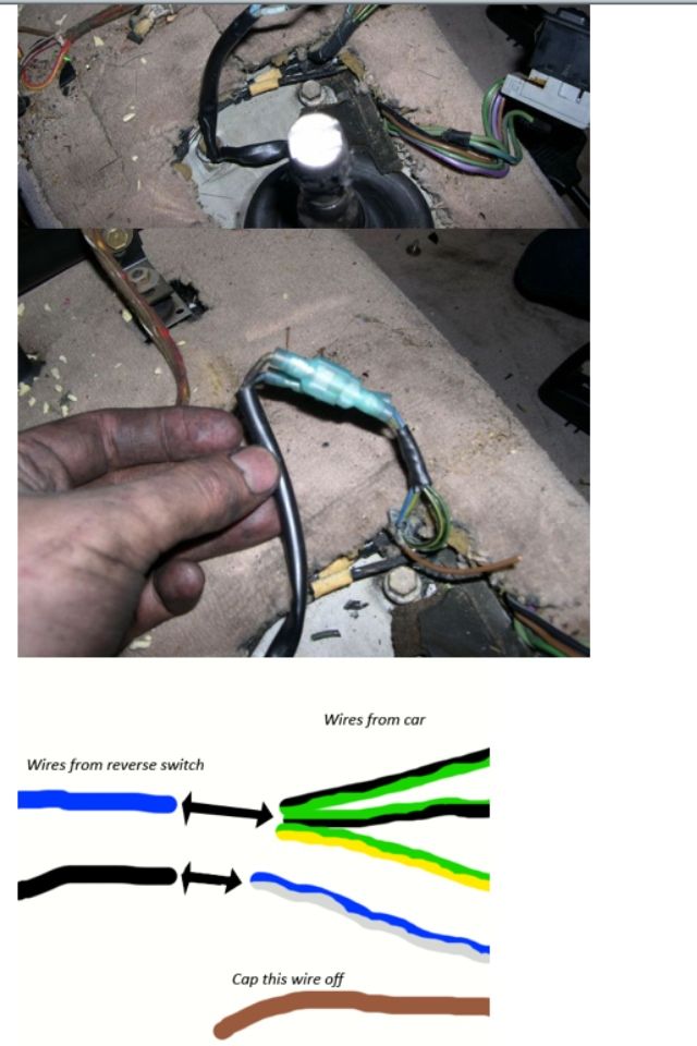

    Disconnecting the auto harness was more annoying than it was worth IIRC. It was simpler to do the wiring in my write up.

      This might help you with the reverse switch as well. I was going nuts trying to figure out what was what until i found this pic. BTW that hand is not mine, lol might be an off topic reply but it will help you.

          I haven't seen yoshi's writeup but if you do the wiring the traditional way, your CC won't work anymore. Removing the auto wiring junk is the only way to deal with that.

              yeah, if you don't need CC, then it's not worth removing the wiring. I never did, as once I converted to MS I didn't need the auto harness jumpered at all to start the car, I just put it back to stock and now my CC works again.

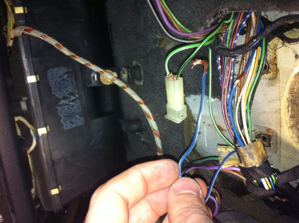

                  OP, do you even have the reverse switch wires that connect to the trans?
                  • 6gen91
                    • 712
                    like i said, i love yoshis writeup, just doesnt help me in my case, heres the pic i took this morning with my iphone, don't hate on the quality!! Theres this little connector with the 2 green wires, and the stray blue wire. On the other side theres 2 more strays, a green/black and a brown

                      you seem to be missing the reverse switch wiring.

                        in all honestly, i can care less if my reverse lights work haha, i just want this badboy to run!!

                          I'm fairly sure the blue/white wire is for the reverse switch. I think you need to connect all the green wires together but I'm not 100% sure. Prob pop a fuse or two lol.

                            yea looks like you dont even have the wiring. the reverse wiring is 2 wires that you should have plugged into the side of the trans and lead in through the shifter hole. that would be the blue and black wires. ( mine were blue and blue/white)

                              this is such a bitch. this is why i was confused when reading your writeup lol

                                well yea. the manual trans should have wiring with it. If not, half the diagram makes no sense.
