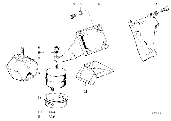

                            92 325ic parts car has engine mounts and heat shield that are different from my 87's 325iC ...
                            Looks like they were made for poly mounts, lol.
                            from realoem ...
                            # 11 Heat resistant plate, part # 11811127493
                            # 12 Stopper, part # 11811133377
                              Those heatshields are standard for the aluminum engine arms, which are shown in the picture. Those are Euro only parts. We always got steel arms with the crash plates. Interesting that your '92 parts car has them (if I read your post right).
                                Yes, the parts car has them on. I'll swap them and save some weight., thanks for heads up.
