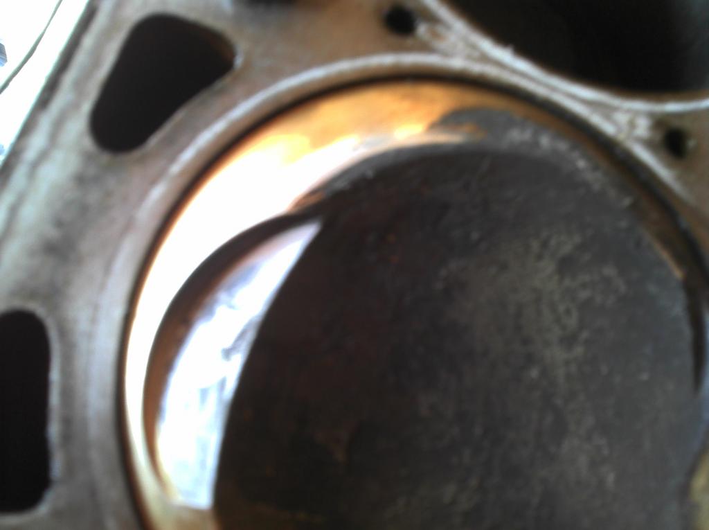

              ill take it apart saturday and hopefully get some nice pics for y'all

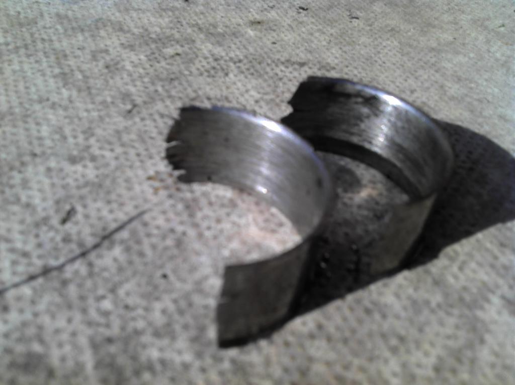

                          the pics arnt great i know but look at the way the shell has been rolled thin and pushed up the sides of the rod. the piston has touched the head obviously because the bearing is so thin. i have spoke to some one about the shell and have an idea what caused it. im sure you will have an opinion on it.
                          • nando
                            • 34839
                            you spun a bearing, severely.

                              Holy SH*T!!

                                That sux dude. I will be interested to know the cause of the problem.
