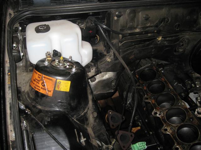

      Looks pretty good but I may try to find something even smaller. Car isn't used in winter and need extra space to mount my coil there also.

            I think I will try to find or improvise something small like no larger than 6x6" and hopefully a little less.

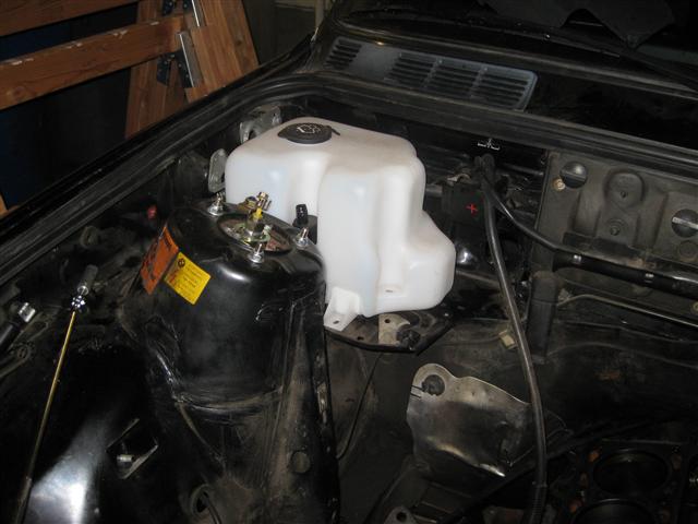

              I have an E21 washer reservoir... its a lot smaller than stock and fits in the stock location. I thought about mounting it but just never got around to it and I've been driving with no wiper fluid for weeks. Kinda sucks.
              -Alex

                This thing (pn 61661357614)?
                Please take a picture

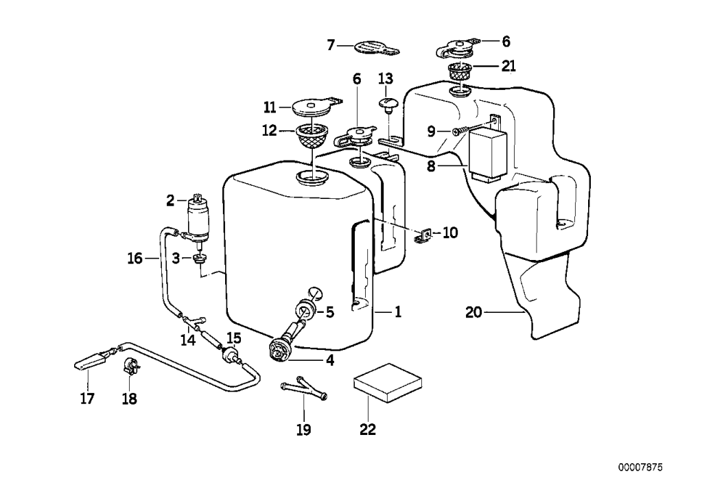

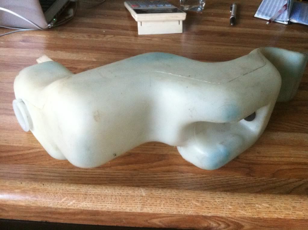

                        If you want to stay oem e30, I have this oddball intensive washer reservoir. I believe it's from the headlight cleaning system of a 325iX, which has the regular and intensive washer reservoirs in separate locations due to space constraints. See page 68 of this euro owner's manuel PDF.
                        And from realoem (disregard the placement, as you can see in the PDF link above where it actually goes in the engine compartment).

                              Interesting, I need a solution to run my top mount turbo with my headlight wash wipe seup. Running the dual chamber corrct part now and was going to try th ix unit in the battery tray but then I mess up the wash wipe setup. Any P/N on that smaller res?
                              This also looks like a E32 intensive wash setup, Robrez the pn on the small ix part is 61671381709, can you confirm? I would be interested in purchasing it.

                                #60
                                Originally posted by browntown
                                your link is broken, this should work http://e30-talk.com/Betriebsanleitung-E30.pdf pg 68
                                Thanks, I fixed the link.
                                The part number on the reservoir is 61671376850, with a date stamp of 6/85. I believe that 61671381709 is a superseding number for the same part, as both parts numbers are linked together on this retailers website http://autoplast.org/catalog/bmw/199...22129/2359589/
                                I wanted to keep this reservoir together with my HCS, but I'd entertain selling it if you cannot find and alternative.
