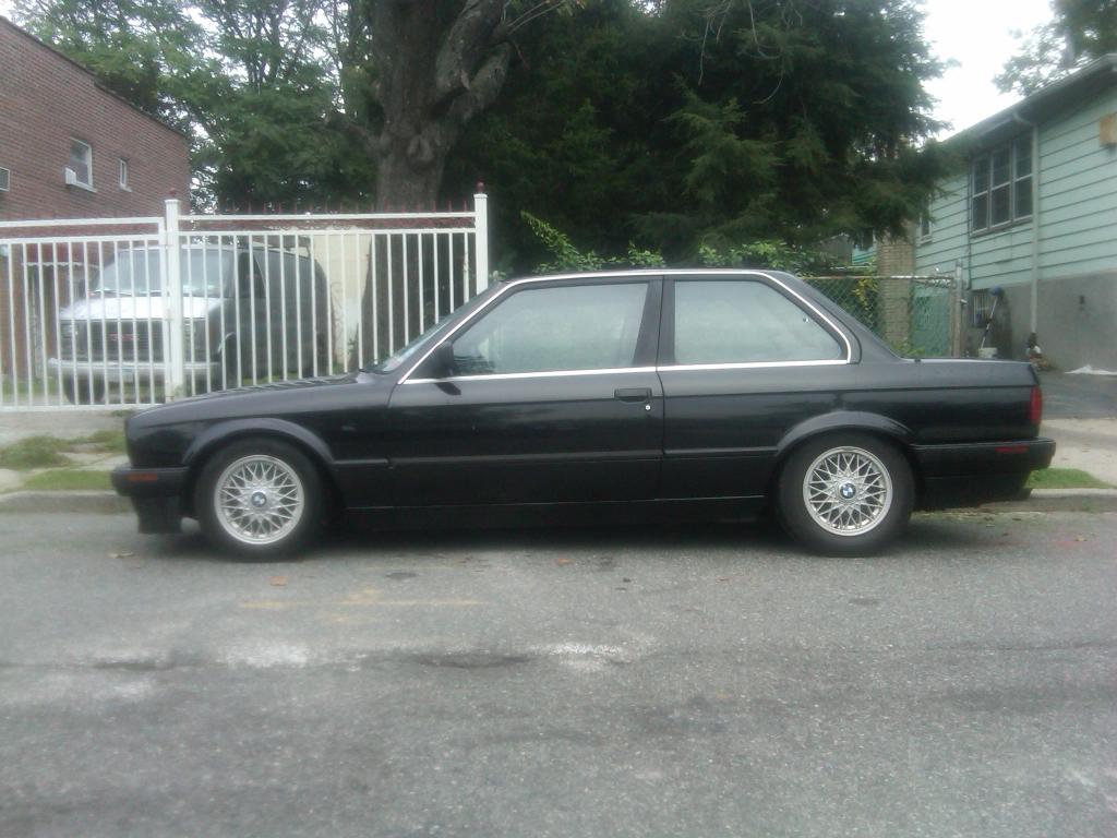

                  • sticksdaman
                    • Apr 2005
                    • 2987
                    All the way down in the front, about a 1/2 inch to go down in the rear.
                    Unmodified housings, GC Camber plates
                    Bilstien Sports all around
                    195/60/14 up front
                    195/65/14 in the rear
                    I'd like to go lower still...

                    • Blackout
                      • Apr 2011
                      • 4130
                      ^^^^^ Do billys bottom out occasionally ?

                        • sticksdaman
                          • Apr 2005
                          • 2987
                          yes, ANY stock length shock will when lowered all the way on GCs. The ride isnt bad though. 450f/650r
