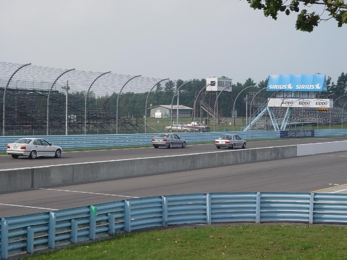

            With a Dinan Stage 1 suspension for the iX, the car handles really well. My sister has a 1991 325iX with the full Dinan kit (chip, intake manifold, exhaust, suspension) on her car, and she does very well. She's in the advanced run group at our local BMWCCA, and she can haul ass pretty well. She can hang with stock e30 M3's through the corners quite easily with R comps. I had the opportunity to drive it at the track once, and I can tell you, it's a different beast. It took me nearly 2 sessions to realize I could go way deeper into the turns, and accelerate way sooner. And in some, I could just tap the brakes, and then power through the turn the whole way.
            Don't believe me, then take a look:
            Here she is all over the ass end of an e36 M3 going up the esses, right before she passed him just a short while later (he wasn't hitting the corners right):
            And here she is going up the front straight after turn 11, and passing 2 e36 M3 sedans. You can even see the guy in the silver sedan giving her the point-by:
